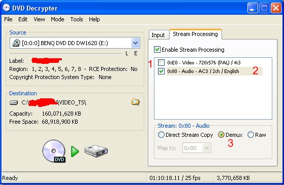

Get a screencap of the screen you get in this section:
3. Once done, uncheck all boxes except one audio track, normally it will be a AC3, but it could also be a WAV or MPA file, it must be 2 channel only, surround is not supported. If there is more than one 2 channel audio file, go for the first one on the list, the others may be directors commentaries etc. Once you have selected the correct audio track, select it, and then select the "Demux" option instead of the "Direct Stream Copy" option.

You should be getting an AC3 file after demuxing - if not, then you're not doing something you should be doing. You need to tick (or leave ticked) the audio you require, but then you also need to click on that audio stream once, and then click on the demux button.Originally Posted by happydog500If in doubt, Google it.

Instead of doing step 3 from the guide, do this, in the exact order that I have specified here:
1. uncheck all boxes except one audio track.
2. left-click once on the audio track you're keeping, so that it is highlighted in blue.
3. select the "Demux" option instead of the "Direct Stream Copy" option.
Now if you only have one audio file ticked, and you definitiely have selected that file and then clicked demux, then you will get one AC3 file for each chapter. You should not have the video stream(s) or any other stream(s) ticked, so there should be absolutely no other files - no VOBs, no nothing. Just simply 1 AC3 file for each chapter.
Now follow the rest of the guide.If in doubt, Google it. -

Just to help anyone, the problem was that I did have the Demux checked, but what I did was have the (guide) screen in the background. I would click on the screen to get the DVD Decripter box to go to the taskbar so I could read the guide. When I brought it back up, it wasn't in the demux mode. Since I already checked it, I never looked at it agin when I brought it back up. Chris.
