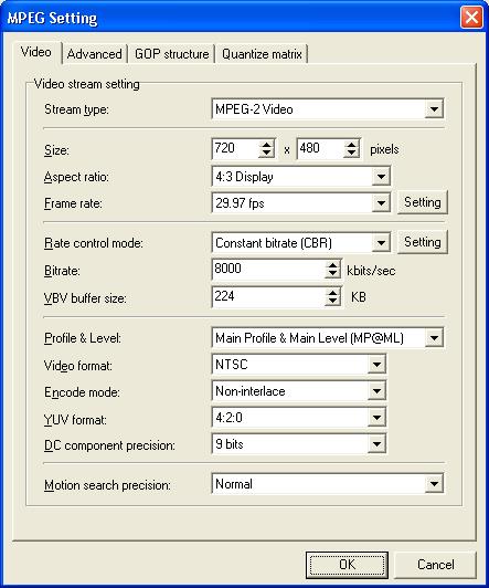

If you want an easy, quick, dirty strategy that will probably work for all your AVI files use something like the following settings:
The results will be a little jerky (because of the crude frame rate conversion) but otherwise the picture quality should be about as good as the sources (unless your sources are high def). And you will only get 1 hour on a DVD -- a tremendous waste if your sources are 320x240 or something like that.
TMPGEnc uses a crude bilinear resizing algorithm. To get better resizing you can use AVISynth and its LanczosResize filter.
If you want non-jerky results you'll need to use a better frame rate conversion method. There are about a million threads here that deal with that.
