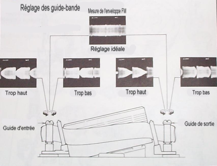

  9. Member edDV's Avatar
    Mar 2004
    Northern California, USA
    Originally Posted by davideck
    Originally Posted by edDV
    A proper alignment results in linear tracks. A worn machine produces arc shaped tracks.
    Could you please describe how an arc shaped track is produced?
    From mechanical misaligned guides.
    This is in french but shows the issue.
    also see http://electronics.howstuffworks.com/vcr2.htm
    http://www.kiva.org/about
  10. Preservationist davideck's Avatar
    Feb 2003
    USA
    Yes, I understand how misaligned guides can distort the RF envelope.
    So the "arc" you referred to was the shape of the RF envelope and not the geometry of the tracks on tape?
