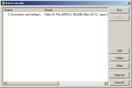

File > Add current project to batch list > MPEG file, choose filename.Originally Posted by zworg2
You can then close that window, set up your 2nd encode, and then do the same thing, and it will add the 2nd one to the list. Continue as long as necessary, then go to File > Batch Encode, and click the Run button when you want it to start.
