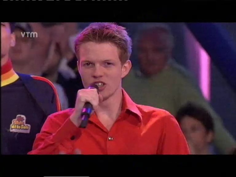

    I'm a newbie into repairing video quality so I have a question.
    I have a tv card from pinnacle where I record with, but after capturing I have some noise into my video, but I found on a website that it's normal if you have noise when capturing thru analog tv cards.
    Here is a picture of the result:
    I also read on the internet that you can repair these kind of noise with VirtualDub, but now my question:
    What do you guys think are good vitualdub filters to repair this and to make this look good onto dvd and which settings would you use?

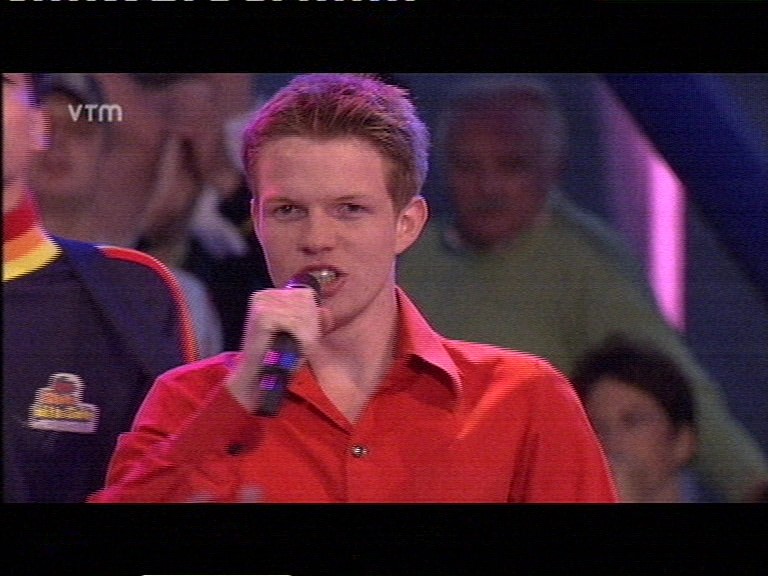

  7. Aside from resizing to DVD specs I'd leave the video as it is.
    But... I've found that the X.264 codec can remove a lot of noise from noisy video. The codec does a lot of temporal and spacial filtering to get very high compressions. Here's a before and after (Smart Deinterlace, X.264 in single pass Quantizer mode at Q=30) shot:
    Before:
    After:
    I don't really see this as an improvement but some people will like the noise reduction.

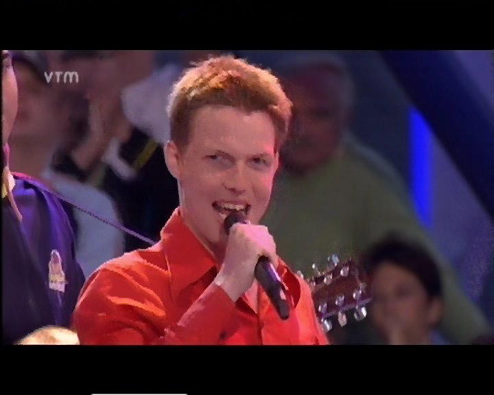

    Avisynth is a powerful program that acts as a video processing frame server. You'll have to learn some of the syntax on your own - it is too much work to explain in a single reply post.
    It looks like this -
    SourceVideoFile-------->AviSynth------>AviSynthFilters----->Encoder--->TargetVideo
    You need to install AviSynth 2.5, then create a Script file which will tell AviSynth what to process. All AviSynth scripts must have a .AVS extension.
    Example:
    Jelleke.AVS
    LoadPlugin("d:\avisynth\fft3dfilter.dll")
    LoadPlugin("d:\avisynth\defreq.dll")
    DirectShowSource("d:\avisynth\test.avi")
    converttoyuy2()
    DeFreq(fx=20,fy=-50)
    fft3dfilter(sharpen=0.6,bt=0,sigma=5)
    ######### end#############
    You can then open Jelleke.AVS in VirtualDub or TmpgEnc or another encoder and it will filter the source file with the AviSynth settings.
    Here's an example of the before and after using AviSynth -
    Looks OK in a still image, but that broadcast noise is still there (only less so).

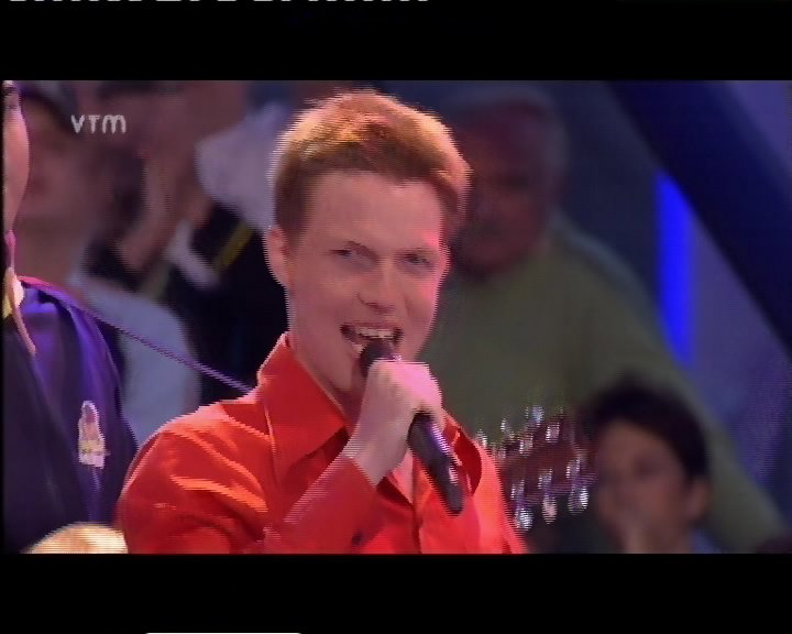

  9. Member Soopafresh's Avatar
    Jan 2004
    Hey Junkmalle - looks like we both chose the same frame !
