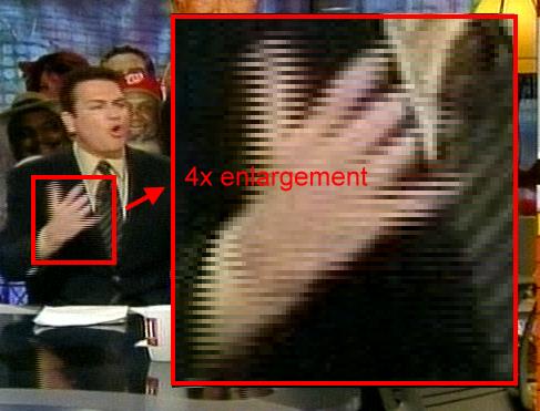

MPEG files have interlace/progressive flagged within the file. AVI files do not. But even with MPEG files the flag may not be correct. The only way to know for sure is to look for yourself. Interlaced material will have files that look like this when there is motion:
Don't use a media player application to look for this. Many of them will deinterlace while playing because interlaced video looks so bad on a computer monitor. Use a program like VirtualDubMod which does not deinterlace. -
ok thanks junkmalle, now i know how to identify a file from interlaced/progressive... But how do i find the field order?
I've been using TMPGENC Xpress 3.0 for this... i open the file and it gives me the field order... Is there any other way?
Thanks -
