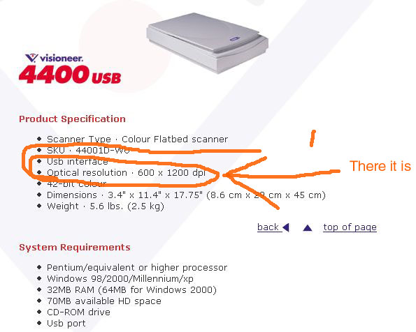

"Find out the optical resolution of your scanner."
I knew I was missing something...but I just don't see any options for interpolation or lack of in the scan manager...
It's a Visioneer 4400 USB scanner...
My neighbor is laffin his ass off and doesn't understand it either so I'm not alone.
Thanks -
So your choices are 300dpi or 600 dpi for that object size.
BTW: "600 x 1200 dpi" is a marketing way of saying 600dpi.Recommends: Kiva.org - Loans that change lives.

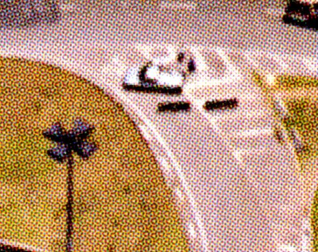

Raga is correct. Anything printed on paper proably was probably printed at 1200 dpi with 6x6 half tones. The final resoution is something like 200 dpi. Go much higher than that and you will just get big dots.Originally Posted by Raga
Here's a 1200 dpi scan of a postcard:
The same section at 300 dpi with descreening:
