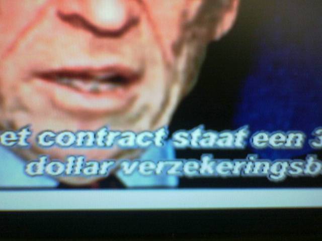

    I'm creating a DVD with maybe 4 videos inside (Menu and chapters too) and i want to add subtitles to the main video.
    I follow this tutorial and i made it (14 subtitles to the main video and menu & chapters still there)
    BUT the subtitles displays all in grey and white and in big words and the worse thing is that i can only play the subtitles in a PC and only if i open the main video file. Because if i play the movie from the menu the pc don't find the subtitles.
    My objective is to creat that Munu, multi video with subtitles whitch works on stand alones DVDs players and with decent subtitles.
    PLEASE SOMEONE HELP ME

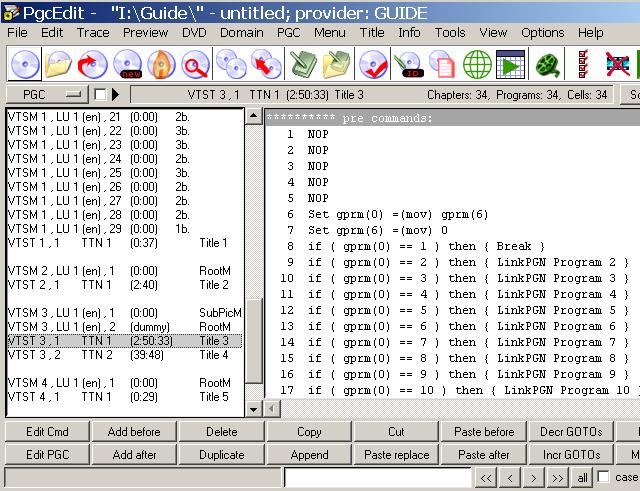

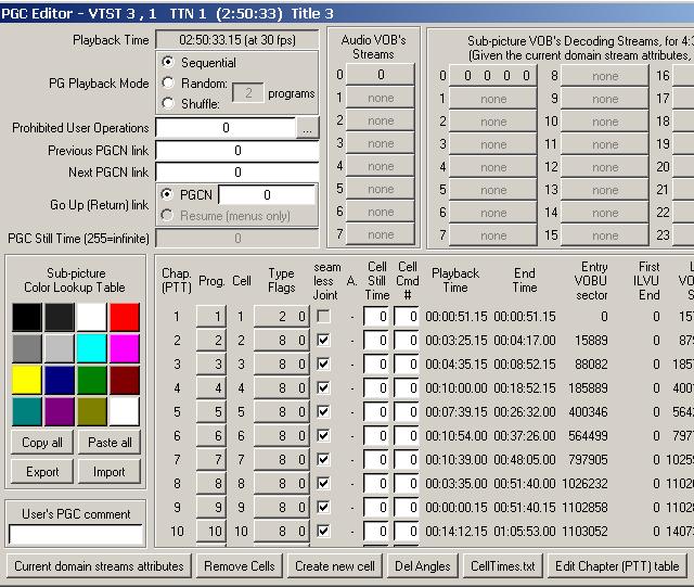

  10. Hi-
    1. One of the subs is for widescreen TV display, and the other is for 4:3 TV display. Even though you included 2 subs (of the same language), only one will be shown in PowerDVD or by your DVD player. They are supposed to switch automatically. And the first is supposed to be Wide and the second LB. If you have only 2 sub streams and they're for 2 different languages, then each is both Wide and LB, and you'd load each sub and click both Wide and LB.
    2. Yes, open the final DVD with the wrong colored subs in PGCEdit. Remember which is the outline color and which is the main color. Double-click the video, and in the new screen you'll see the 4x4 block of colors. In the top row you should see your 2 colors, Click on each and change to whatever you like. OK, Save DVD, and test.

  12. Come on, man, this isn't rocket science. Did you even try what I described? Open the DVD in PGCEdit. Here I've highlighted the video in the left panel. Then double-click on it:
    A new screen will open up. Among the things you'll see are the CLUT (Color LookUp Table, or the 4x4 block of colors). 2 of the colors, probably in the top row, will be what you have for the outline and main color of your subs. Click on them one at a time and change the colors. Maybe you want the outline as black and the main color as white or yellow or grey. Whatever. Then, after you have them the way you want, OK your way back to the main screen (the OK button isn't shown in that pic because I cropped it). And then File->Save DVD. Not hard.

    I'm having troubles after I replace the files with Voblanker,
    the subs play fine but when I replace the pcg , the subs in the reauthored folder plays all grey.
    Before I replace them the subs were fine.
    Any idea?
  27. Any idea?
    Yes, change the colors. There are several ways to do this, but because there's a guide for it, I'd suggest using DVDSubEdit for the job:
    http://download.videohelp.com/DVDSubEdit/Guides/ChangingColors/Guide.htm
