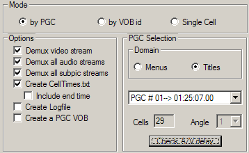

2. Run PGCDemux. Click Input IFO's 'Browse' button and open the .IFO file that contains
your main movie (usually VTS_01_0.IFO, but could be different). Make sure the domain is
'Titles' and that the length of the movie is correct. Note the PGC # shown here. This is the
PGC you'll be working on later. Choose "demuxed" as your output
directory. Check 'Demux video stream'. Click on 'Check A/V delay'.
If the delay is anything other than '0 ms', write it down, as you'll need this info later.
Click on 'Process!' to demuliplex.

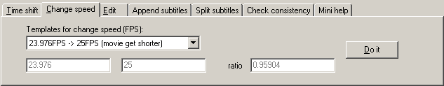

b) If your subtitle is in a different frame rate, then open it in Subtitle Tool and in Change speed tab,
choose the template you want and click on Do it.

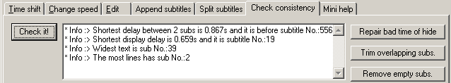

c) Also while you are here, goto Check consistency tab and click on Check it! button. Make sure
there is no error and all you get are the Info:> lines.

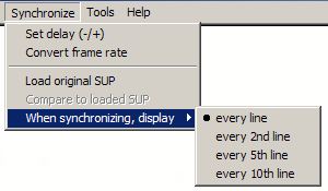

video format, etc. Do the usual color/font selection and position adjustment. If you want to check
if the subtitle will be in sync, goto Synchronize->Load original SUP and open the .sup file in the
"demuxed" folder. Then you can compare the time of each line to make sure the subtitle is in sync.

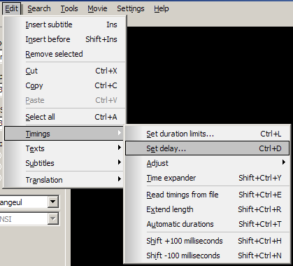

b) If you want to do a simple synchronization, then you can probably get away with linking the first line
and the last line then clicking on Synchronize button. But I prefer to use Subtitle Workshop and use
it to add/subtract delays.

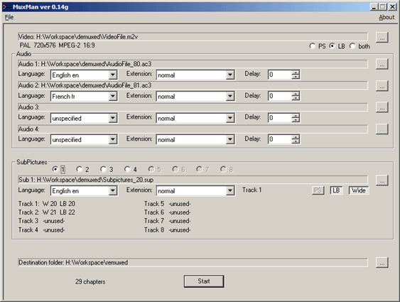

5. Run MuxMan. Click on ... button and add your video, audio, and subtitles from the "demuxed" directory.
Select ouput folder as "remuxed". If there were any audio delay, put it in here. If you want to keep the original subtitles, load them in the correct order (you can tell the order by the filename: Subpictures_20.sup is the first, Subpictures_21.sup is the second, and so on). If you created 2 streams for a subtitle, add the wide version first and click on wide button. Then for the next stream, add the letterbox
version and click on LB button. Make sure that the languages of both streams are the same. If you have just
1 stream, load it and click on both LB and wide. Lastly, goto File->Import Chapter and open CellTimes.txt in
the "demuxed" folder. Click on Start. If you get an error, you can try Rejig or IFOEdit to remux, but they
can't combine letterbox and wide versions into one stream.

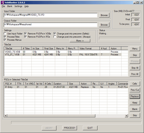

7. Run VobBlanker. Click Browse of the Input Folder and open the VTS_TS.IFO from the "original" directory.
Set output as "reauthored" directory. In the title set, choose the title set that contains your main movie.
All the PGC's of that title set will be displayed in the lower table. Click on the main movie (usually PGC 1,
but could be different) and click the Replace button. Choose the VTS_01_0.IFO from the "remuxed" directory.
For multi-episodes, you need to do this for each episode/vob. Then click on PROCESS!!. A log window pops up
to let you know what it is doing. After it's done, close the log and exit.

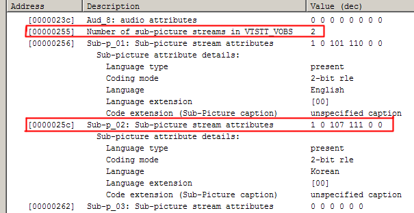

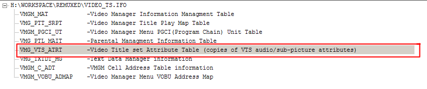

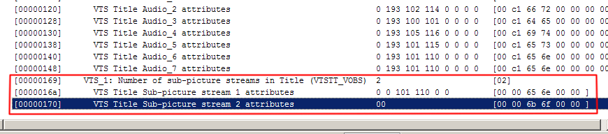

9. a) Run IFOEdit. Open the VTS_TS.IFO from the "remuxed" directory. Click on VMG_VTS_ATRT, in the lower window,
scroll down to the VTS of the main movie (in my case, VTS_1). At the end you'll see the subtitle information.
Note the number of sub-pictures. Double click on the newly added subtitle (in my case, Sub-picture stream 2),
and note the hex numbers shown.
b) Open the VTS_TS.IFO from the "reauthored" directory. Go to the same place and modify the values to match the
information from remuxed video, by double clicking on the item you want to change. If the number of subtitles
were reduced, you can zero out the removed subs. Click on Save button and answer yes when it asks to save .BUP
file as well.

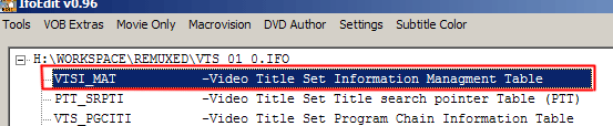

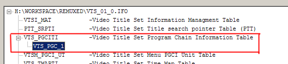

c) Close and reopen IFOEdit. Open VTS_01_0.IFO from the "remuxed" folder. Click on VTSI_MAT, and in the lower
window, scroll down to where subtitle information is shown. Note the properties of the newly added sub. Open
the .IFO file that contains the main movie from the "reauthored" folder. Again, goto the same location and modify
the values to match the one from "remuxed" by double clicking on the Sub-picture stream attributes. Make sure you also change the Number of sub-picture streams in VTSTT_VOBS to the correct number or your subtitle won't show up!

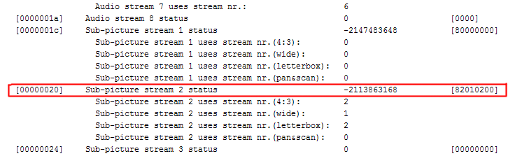

d) In the upper window, click on the .IFO from the "remuxed" folder. Double click on VTS_PGCITI, then click on
VTS_PGC_1. Scroll down to the subtitle information. Double click on your sub-picture's status. Press Ctrl+C to
copy this value. Go back to the .IFO from the "original" folder, to the same location (PGC number might be different!). Double click the
sub-picture's status and press Ctrl+V to paste the value. Again, you can put zero to the subtitles that have been
removed. Save the file. Finally, play the file now to see if the new subtitle show up. It should show up and

All you have to do is open up the .ifo of the main movie in IfoEdit (after you have replaced a subtitle).
You'll see the subtitle information as Subpicture 1, Subpicture 2, etc.
There is a flag next to it representing the language of the stream.
Double click on the one that has been replaced and change the language to the one you want. -

When I try to use Muxman to mux it all together it says it can't proceed because of excessive bitrate. Is there any way around this? Lowering the video quality is not an option and should not be necessary, seeing as what I'm trying to work with is of course from a normal DVD. The only thing I'm trying to do is add english subtitles to a japanese DVD.

My second suggestion is related to VobBlanker: the latest version has been improved a lot, and now it does allow you to copy the color palette, it fixes the VIDEO_TS and other IFO files, such that it is no longer necessary to use IfoEdit at all! An impressive achievement!
Title PGCs in IFO section: Check Clear audio/subs status when blanking/stripping
Replacing section: Check Fix elapsed time, copy PGC stream control, Copy VTS audio/subs.
