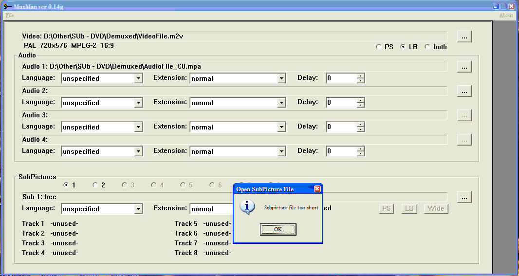

    I tried using this method (described in the firect post how to add subtitle to DVD) but when I got up to MuxMan v0.14g, I couldn't load the subtitles SUP file: it said that the subpicture file was too short.
    What do I do, what is the problem?

    The first thing I would suggest is an update of your Muxman, as the free version is up to 15R now and yours is quite old. I haven't seen that message before, but if updating doesn't work I would next check out the SUP file to see if it's good. SubtitleCreator and DVDSubEdit can open SUP files and read what's inside. If the subs look OK, then I would next go to the (HD) DVD & Blu-ray Authoring Forum at Doom9 where the Muxman developer (mpucoder) moderates and ask there. You'll have to wait 5 days after registering before you can post.
    If you created this SUP file yourself then there's probably something wrong with it and Muxman rejects it for very good reasons. If so please explain the SUP file creation steps and maybe I can point you to a better method, one that Muxman will accept. By the way, this guide is fairly old (although maybe still useful). Better is the Method 2 of Baldrick's guide:

    The problem is much simpler. You didn't add the subpicture file as I see in the picture you posted.
  6. No, Muxman didn't accept the SUP file he tried to load, so nothing shows in the SubPictures section.

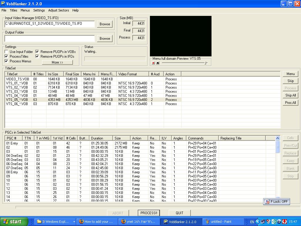

    im tring to add subtitles for the series "burn notice" and as i adding subtitles to the second cd (episodes 4-7) i come up against a problem after using the vobblanker when after the vobblanker finished working the subtitle i added was actually missing and all there was , were the original subtitles.
    i tried to do it twice and same thing happened.

  26. After muxing that episode using Muxman (but before the VobBlanker step), does it have the right subtitles? And if they show up after being muxed with Muxman, did you follow the step in the guide about "turning on" the new subs using IFOEdit? It's a heck of a lot easier to do that in PGCEdit, but the guide is using IFOEdit for that job.
    Also, I think you did the replacing wrong as the VTS 05 is all messed up. Can you post a pic of the main screen of the original DVD with the VTS 05 highlighted so it appears in the bottom part of the screen?
    VTS 05: Replacing PGC 04 by C:\New Folder (5)\video_ts\VTS_01_0.IFO
    Cells to be replaced =1.
    Cells in replacing VOB=18
    It shouldn't be like that.

  28. As I suspected, you're replacing the wrong thing. You can only replace PGCs 1 and 2 in that VTS. The others are empty, as you may notice. They have no size and are marked as reused. They only reference the earlier PGCs. This means you have to demux only PGCs 1 and 2, and create the subs for only PGCs 1 and 2. Don't do anything with PGCs 4, 5, 6, and 7. It looks like each of the first 2 PGCs include 2 episodes, assuming this is an episodic DVD of some kind. If you created new subs for each episode separately, you'll have to combine them.

  30. No, according to the VobBlanker pic you uploaded, each of the first 2 PGCs contains 2 episodes. Look at it. The length of PGC 1 is 1:25:38. The first episode's length (from PGC 4) is 42:32. The second episode's length (from PGC 5) is 43:05. Add them up to get the length of PGC 1. Maybe you didn't demux by PGC, but by VOB ID. I don't know, but you did it wrong. There's nothing really wrong with demuxing by VOB ID, if each is an episode. The problem comes when trying to do the replace in VobBlanker as you can't replace by VOB ID, but only by either PGC or by Cell (after hitting the "Cell" button to the right).
    Also, according to your log, you tried to replace PGCs 4, 5, 6, and 7. You should have been replacing PGCs 1 and 2.
