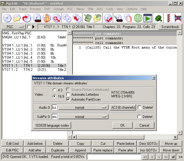

  5. That method described in Step 9 is obsolete. Follow Mystiqq's variation on Step 9 described farther down on the first page of the guide and see if you have better luck:
    https://forum.videohelp.com/topic275603.html#1363600
    PGCEdit has changed a bit since he wrote that. After you add in the subtitle stream, go back out to the main screen and find the icon at the top that looks like a green reel of film. Hit it and it'll say something about a new subtitle. Hit yes, and in the new screen you can choose the language to identify your new subtitle.

  8. Hi-
    The DVD is 16:9 anamorphic widescreen.
    But when I demux the video in PGCdemux, the resulting .M2V video is 4:3.
    It's unusual, but not unheard of. The video was encoded as 4:3, but the IFOs were set for 16:9. Since DVD players play the IFOs, it played fine. But when you remux with Muxman, the IFOs it creates take the DAR from the DAR of the video and it then plays wrong. 2 fixes come to mind.
    1. Change the M2V from 4:3 to 16:9 before authoring using ReStream. Then you shouldn't have any trouble muxing the way you want, using Muxman.
    2. After making the 4:3 DVD, open it in PGCEdit, right-click the video and hit Domain Stream Attributes. Then change it from 4:3 to 16:9 (probably with Automatic Letterbox, instead of the way this pic has it), OK out to the main screen and Save. And test.
    That way will make it like the retail DVD. This all assumes I understood your problem and what you were asking, not always true.
