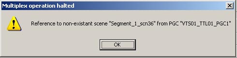

    hello, another thing i faced during subtitlting with new Sony movies, like Basic Institct 2, RV..
    i am facing a problem with MuxMan that keeps getting an error at the end of its work. and testing the result dvd showes it wont work, if u keep going on to VobBlanker, it will give another error at the end, and the result wont include the subtitle i added.. kept trying for days searching the internet, but couldnt find a solution..
    the only thing i figured, that if i dont import the chapters in MuxMan, then it will work fine till the end and to VObBlanker, and the DVD will show the result with the subtitle i added with menus with everything.. but... no chapters... have to watch the movie from the beggining to the end as one piece.. and that sucks!
    any one faced this thing before? or anyone have a solution?
  26. Hi-
    Maybe it would help if you said what the error was. You can find the Muxman log in the root of the C drive. I think I know what your error is, but I refuse to guess.

  27. Member
    Join Date: Dec 2003
    Location: Middle East
    Also, if you decrypted these new DVDs you mentioned using RipIt4Me in the first place, the chances are very good you wouldn't have these synch problems.
    done that... didnt help either..
    this problem i faced in: Final Destination3, Basic Instinct2, RV, Scary Movie 4, Sentinel.. and i guess they all a Sony made.. they will only work if i dont import the chapters in MuxMan.. and the error that muxman reports attached as an image to this msg...
    [/img]
  28. When you see that message, delete the last cell in the Celltimes.txt and mux again.
    To keep that sort of thing from happening in the future, open the LogFile.txt and find the total frames line:
    Total Number of Frames=263170
    Then open the Celltimes.txt file. If the last frame number listed in the Celltimes.txt file is within 30 frames or so of the total number of frames in the LogFile.txt, delete it. When replacing using VobBlanker, it'll throw a warning which you can safely ignore.
    And I apologize for the RipIt4Me and the asynch audio remark from before. I was thinking of the previous poster who was having problems with asynch audio.
  29. Member
    Join Date: Dec 2003
    hello again manono..
    tried your last post on "The Sentinel".. deleted the last row of cell number from "Celltimes.txt".. muxed it.. muxman didnt report the error mentioned before, but the result didnt work... even though, i kept going with VobBlanker, the result ran the menu.. but playing the movie will get you back to menu..
    also checked the celltimes.txt last cell with Total Number of Frames in logFile.txt, it was like this:
    Total Number of Frames=194251 (in LogFile.txt)
    last row for celltime= 194236 (in CellTimes.txt
    so still to make it work i had to do it without importing the celltimes..
  30. Hi-
    Are you saying that the Muxman authored DVD (before replacing in VobBlanker) didn't work?
    I was only answering about your Muxman error. I'm not responsible for it not working, as I have no idea what went on before then. However, I have heard of a couple of instances of Muxman not working, but authoring in IFOEdit did work. You might try that next. It takes the same assets in the same formats as does Muxman. To author, go DVD Author->Author New DVD up at the top.
    Yes, that's a good example where checking before authoring, and deleting the last Celltimes.txt frame number, will save you from a muxing error.
