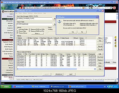

    Okay, but when I make two replaces I'm losing the audio of the Special Features. Any ideas?Click image for larger version

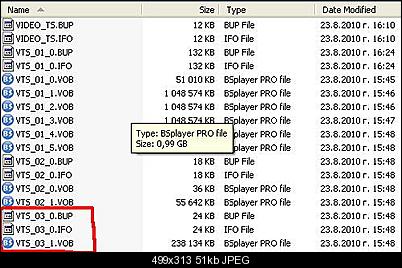

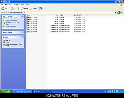

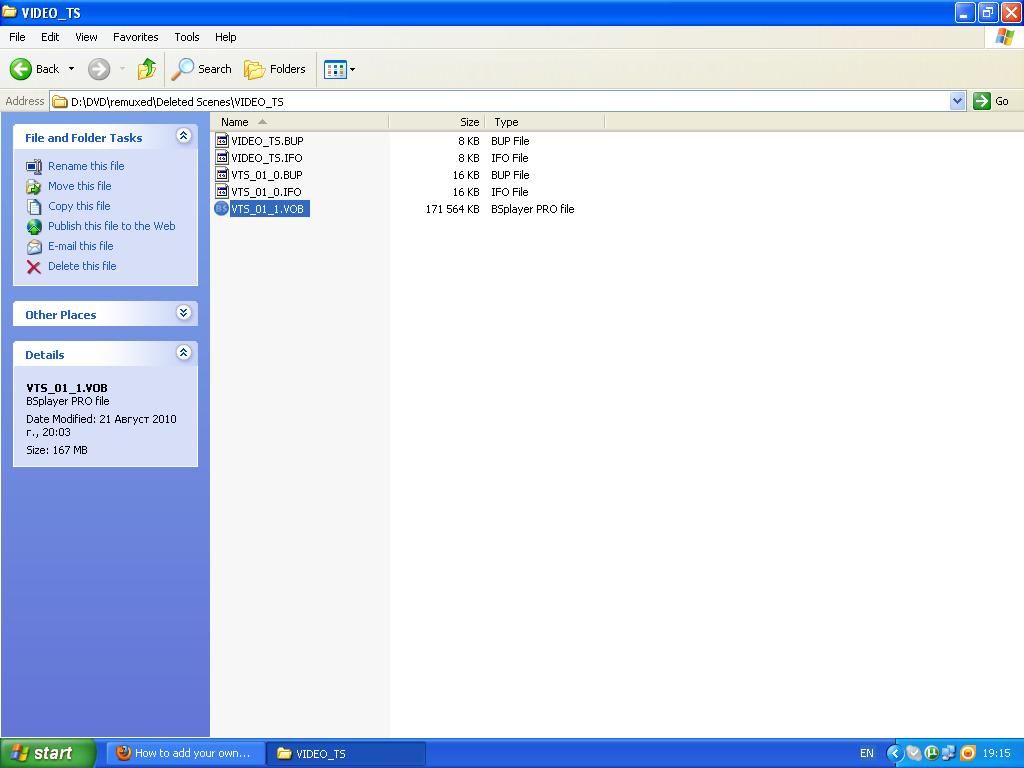

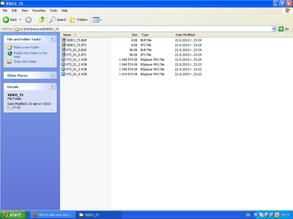

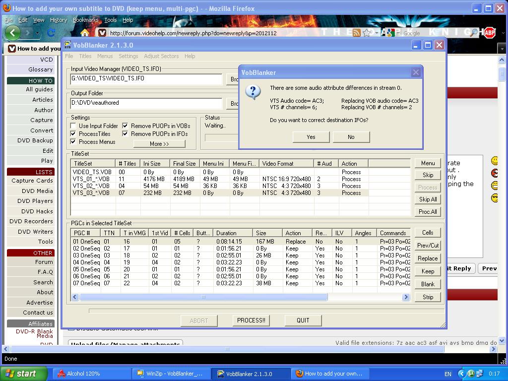

    Still can't make it work. The main problem is MuxMan cannot process both the episodes and the special features at the same time and thus creating two separate VIDEO_TS.IFOs (one for eps and one for SF - it makes two separate reauthored DVDs). And then when using VobBlanker it only replaces the IFO of the main movie and that way I stay with only the subs I've added for the main movie and the ones for the Special Features stay intact (without mine).
Name:	Main movie (episodes).JPG
ID:	3209This is the structure of the main movie - the episodes.
Name:	Special Features (deleted scenes).JPG
ID:	3210And this is the structure of the Special Features - The deleted scenes.
    As you can see they have the same titles of the main files.

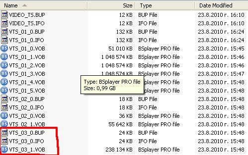

    Okay, I've managed to add new subtitles for the main movie. Now the bigger problem is how to add subs for the
    special features as well and retain the structure and the menu? Here's the structure of the reauthored DVD:
    The highlighted in red are the special features.
  14. That pic is useless. Refer back to your first one from VobBlanker. You have 3 titles (with size) in the 3rd VTS. Add in the subs to each of the 3 title/PGCs (or maybe to just the first one, depending) and process. You could have done the whole thing all at once.

  16. By replacing the main movie at the same time as the extras, using VobBlanker.
    Aug 2010
    Bulgaria
    I tried but it didn't work. It showed the message for the sound channels I posted earlier and there was no sound afterwards.
  18. Then you either replaced the wrong PGC or did something wrong using Muxman. I already told you to play the Muxman authored video to make sure it was the one you wanted to replace. Did you do it?
    Aug 2010
    Bulgaria
    Yes, I did and it still gives me the same error.
