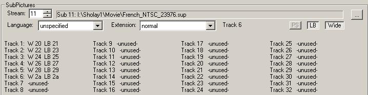

 As you can see on the picture below, my DVD movie has 11 subtitles, from Subpictures_20.sup to Subpictures_29.sup + my subtitle mysub_lb.sup. Is that right? If it is correct it is confusing that it has 10 subtitles coz when playing that dvd I can only choose 3 subtitles(English, Francis and Spanish) on the menu5. Run MuxMan. Click on ... button and add your video, audio, and subtitles from the "demuxed" directory.

 Well I assumed if I want to keep all subtitles I have to add them all, so I decided to add them all. How to add them all? For every stream one subtitle? So that would be from Stream 1 to Stream 10 + Stream 11 for my own subtitle. Right?
	You have 10 original subtitle streams, but only 5 subtitle tracks (plus the new one you're going to create). In such cases (ignoring yours for the moment), one is meant for the Wide stream and the other for the LB stream, for each pair of 2 subs. You loaded each stream once and then hit Wide followed by LB. That's correct most of the time, but not here.

 Since you have the one you created, and it's to be the same for both Wide and for LB, it gets loaded and then you hit Wide followed by LB. I don't know if you want it first or last. I made it last (the 2a track). By making it last, the original subtitle menu still works for the other languages. When all done the subtitle part of your Muxman screen should look something like this:
 And thanks for providing just the right amount of information and pictures so I could properly diagnose what was going on. If you do make yours last, don't forget to "turn it on" if adding it back into the original DVD or else you won't see any subs. I have a post somewhere explaining how to do that...

 This probably doesn't apply to you because it doesn't happen very often, but there's at least a chance that sub 20 is paired with 25 (rather than 21), sub 21 with 26 and so on. To find out definitively, open the original source DVD in PGCEdit, double-click the movie, and in the subtitle part of the new screen you can see how the subs were originally set up. Except for your new subtitle track, you want your final DVD to copy that.
	What you did was to first load 22 and then replace it with 20. In effect you loaded 20 and hit Wide followed by LB. Here's how to do it correctly (I think):I add 22.sup first then click wide,and add 20.sub then click LB.But as you see muxman allways show track 1: W20 LB 20 , not show W22 LB 20 like it should.
 Load 22 and hit Wide.
 Advance the stream number to 2, load 20 and hit LB.
 Advance the stream number to 3, load 21 and hit Wide followed by LB.
 Those are some unusually numbered subs, but that PGCEdit picture tells the whole story. Good luck.
