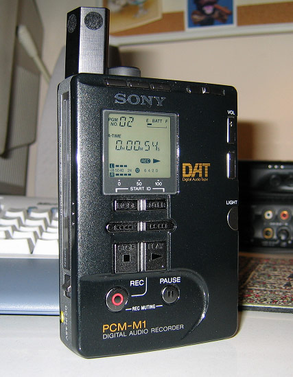

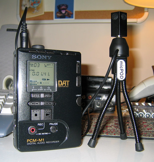

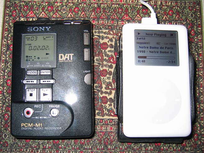

Here are some pictures of my PCM-M1 with Delta and micPOD. Also the size comparison to iPod.

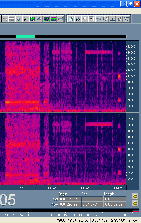

And here's the spectral analysis inside CoolEdit Pro of the sounds made with Canon PowerShot S50 digital photo camera, as recorded by Delta and PCM-M1. As you can see it clearly records sounds 20,000 Hz and above. Also below is the actual recording of those sounds in WAVE format.
pcmm1anddelta.wav
