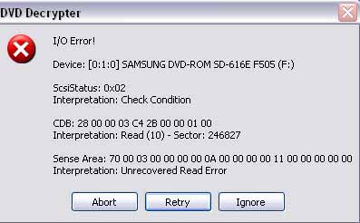

Ok now that I've used DVD Decrypter it is coming with this error message:
DVDFab Decrypter seems to be working fine. Which program do I use now to burn onto a disk?

Sometimes you have to use DVD Decrypter but set it to ignore errors. If it works and you watch the copied DVD you may or may not see a few bad spots that look blocky.
