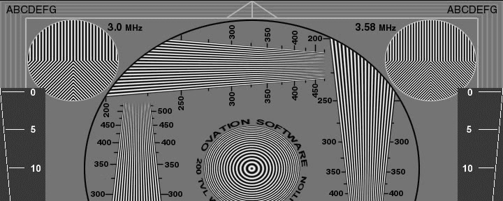

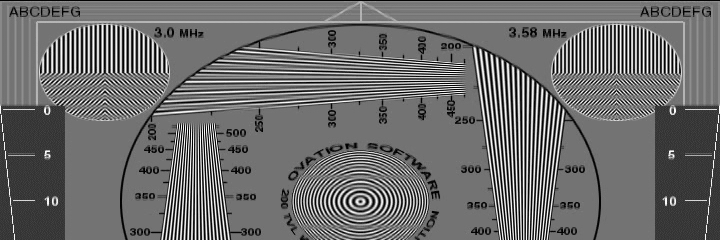

I've never looked closely at TMPGEnc's resizing algorithm so I ran some tests. It appears TMPGEnc uses a simple bilinear resize algorithm. I started with a 720x576 progressive resolution test pattern. I resized it to 720x480 with VirtualDubMod's Lanczos3 filter (what I usually use) and frame served to TMPGEnc. I then resized the source video with TMPGEnc telling it the source was progressive. I resized again telling it the source was interlaced. Here are some crops of the results:
Source:
VirtualDubMod Lacnzos3 resize:
TMPGEnc progressive resize:
TMPGEnc interlaced resize:
The output MPEG files from TMPGEnc were CBR 8000. All frames (I,P,B) looked the same. All still images were saved from VirtualDubMod as 24 bit PNG. I converted them to 8 bit greyscale PNG and cropped to make them smaller for upload.
This type of image is a worst case scenario. Most real world video doesn't look this bad. But this gives you an idea of what types of artifacts to expect. -

Glad you found the comparison useful! I forgot to mention that resizing with VirtualDubMod's Bilinear filter looked identical to TMPGEnc's progressive resize. So TMPGEnc must use a bilinear filter for resizing.Originally Posted by manono
You might find this description of interlaced resizing helpful in explaining why the interlaced resize looks so much worse than the progressive resize:
https://www.videohelp.com/forum/viewtopic.php?p=1343417#1343417 -

As I mentioned earlier, these types of defects aren't as obvious with "normal" video. Try burning the above source test pattern to a PAL DVD (padding to 576 lines tall of course) and watch it. You'll see the same type of artifacts.Originally Posted by rfielder
Don't watch your commercial DVDs too closely. Once you know what problems to look for you'll start seeing them and they'll piss you off! -

Because Lanczos3 is a better method of resizing than Bilinear. It's not the encoder, it's the resize method. TMPGEnc has a built in resize function, which shouldn't be used because it's poor.
Sure, I don't use Bilinear anyway, for that very reason. But it looks as if no matter how you resize it originally, it gets resized again by TMPGEnc using Bilinear, even if only to the same resolution. So, the questions are:

Manono, In each test I started with a 720x576 PAL MPEG file. In the first test I opened the file with VirtualDubMod, resized to 720x480 with Lanczos3, and frame served to TMPGEnc to encode into MPEG. In the second test I opened the PAL MPEG file directly with TMPGEnc and resized to 720x480 telling it the source was progressive. In the Third test I opened the PAL MPEG file in TMPGEnc, told it the file was interlaced, and resized. The pictures posted were from the three separate MPEG files that TMPGEnc created.
I've had a few requests for the full test pattern so here it is...
https://www.videohelp.com/forum/images/guides/p1347262/720x480.zip
This is a 720x480 NTSC frame size. For the above tests I padded the top and bottom to get a full 720x576 PAL frame size (the point of the test was resizing algorithms not aspect ratio).
