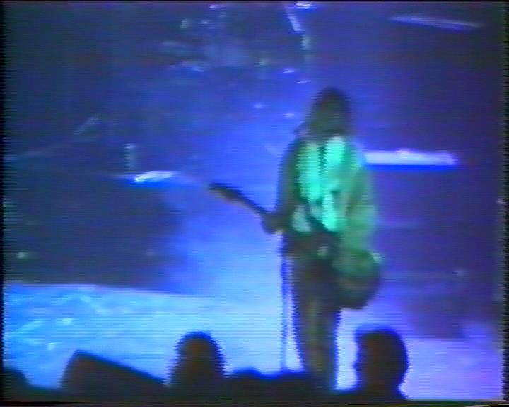

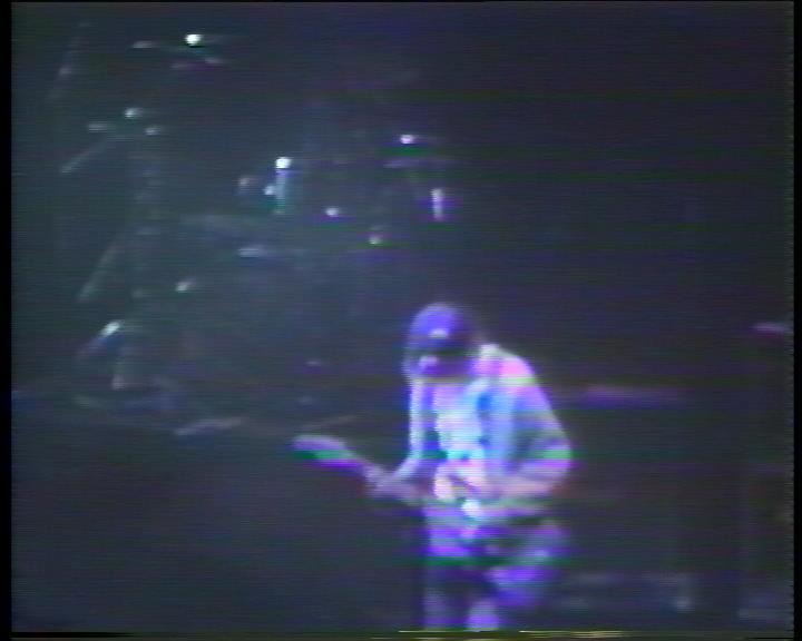

    Spain
    Has a lot of chroma problems... i can't use the built-in TBC of my jvc
  2. Member Fos's Avatar
    Jul 2004
    Spain
    TBC ON
  3. Member Fos's Avatar
    Jul 2004
    Spain
    TBC OFF
