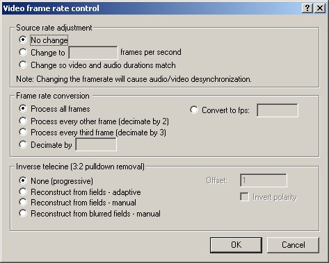

I'm still confused about it and what to do. I see the Frame Rate menu item in Virtualdub. Is this where I do it and if so, how do I determine what settings to change?

So, first I would suggest opening it in VDubMod, finding a place where there's movement, and then advancing a frame at a time. If you see combing/interlacing, then I wouldn't do it in VDubMod. I'd do it using AviSynth. But let's assume it's whole frames you see, although I don't see how it could be. Then tick the Convert to fps box inside Video->Frame Rate and set a framerate. Save under a different name, after making sure that both Audio and Video are set for Direct Stream Copy. No reencoding will be done. In the off chance it's 24fps, you can try ticking Inverse Telecine->reconstruct from fields-adaptive. I don't believe that 8mm is 24fps, but it's worth a try. You can check afterwards for dupe frames. I'm not entirely sure of myself here, as I do this kind of thing with AviSynth. You can't hurt anything, though, as you'll get a new file out of it, leaving the original untouched.

OK, if by jaggies you mean interlacing or combing, then I don't think that you can change the FPS in VDubMod. AviSynth and Decomb might be a better way to go. Assuming it's 29.97fps (File->File Information will confirm that), first use:
Telecide(Order=1) #or Order=0 if bottom field first
Then step through the frames in VDubMod, and you should see whole frames, some unique, and some duplicates. I hope that the capture didn't introduce blended fields into the video. If so, you might be screwed. If you have nice clean frames, then count how many dupes you get in every 30 frames, subtract from 30, and that will give you the original framerate. Then some combination of Decimates appplied after Telecide should be able to get you back to the original framerate. -
