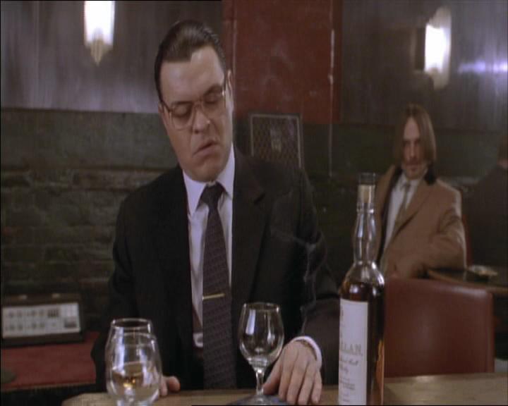

Then that is something other than overscan. Post a pic.Originally Posted by thecrock
I'm not at my own computer at the moment, i will post a screenshot when i get back to it.

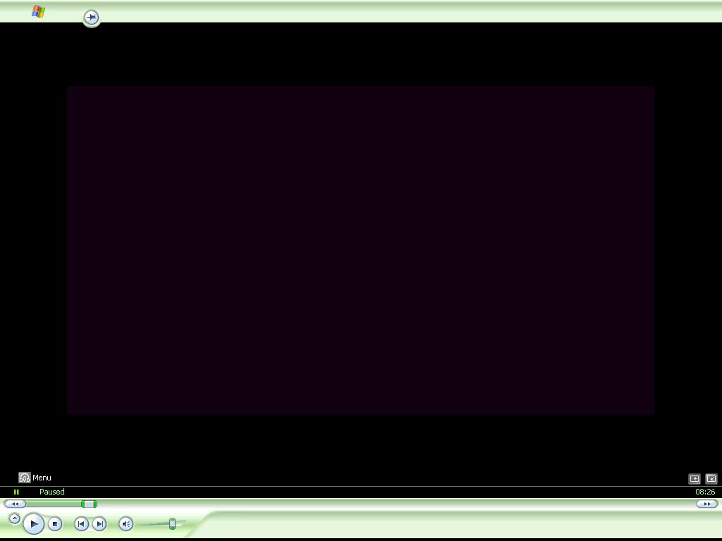

it has both 16:9 1.78:1 and 4:3 1.33:1 Pan-and-Scan on the same DVD. I can't tell from the pic which version you're showing us (there could be some black bars I can't tell apart from the rest of the black). If that's the 16:9 version, then I don't know, unless you're zooming the picture. Have you checked to see if you have one of your zoom modes on? Just a guess. If not, that's a helluva overscan. -
You need to put another screenshot up in order for us to tell. Black doesnt work so well.

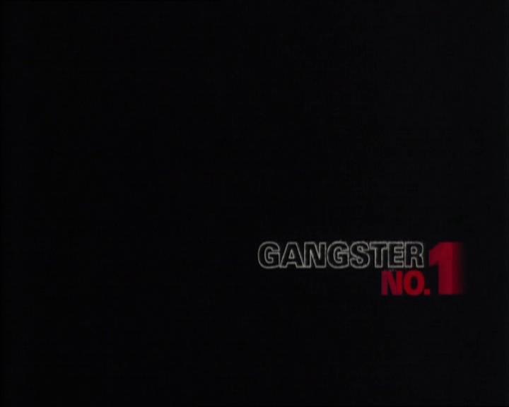

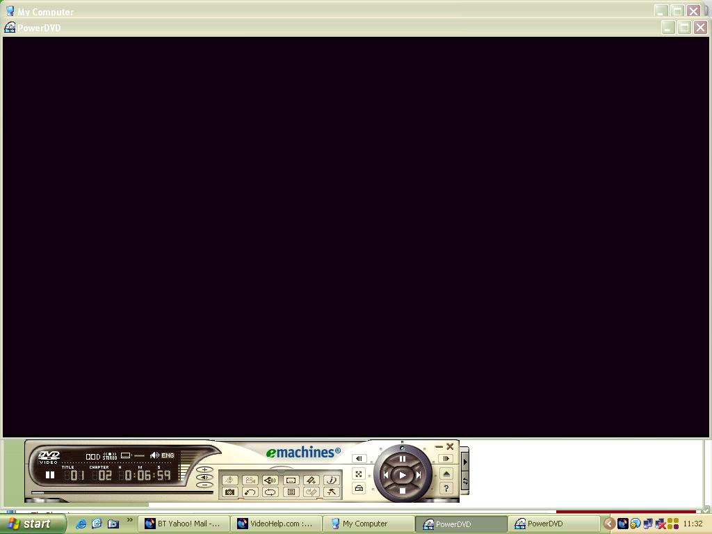

My first screen capture was with power dvd and as you can see it doesn't show the black bars. Here is another, the blackpart of the screen is the entire frame,though i don't think it'll be much help!
He who makes a beast of himself gets rid of the pain of being a man. -
There is no reference point on the shot of the titles, but this shot looks like an incorrectly authored widescreen enhanced movie. The 16:9 flags have not been set correctly, so the player sees it as 4:3 instead. The title should be 1.78 : 1 instead. The giveaway is the tell-tale horizontal compression, making everyone look tall and thin.

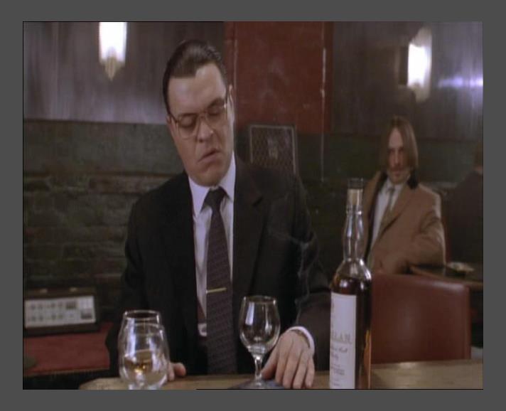

If your backup is working properly you should see something like this on your TV:
As others have mentioned, TV's are designed to overscan the image so you normally won't see the outer 5 to 10 percent of the frame. Computer monitors do not overscan so you see the entire picture. The area outside the red lines (5 percent) is normally not visible on TV.
You're TV may overscan by more than 5 percent or the picture may not be centered well (quite common).
If you really want to see the whole picture you have to shrink the source and add a border around all four edges:
(I added the border in gray for clarity but you would usually use black.) Now when the TV overscans the image the border will be in the overscan area, not the movie.
Don't bother adjusting the border so that the movie perfectly fits your TV's viewable area. You'll find that TV's vary in the exact amount of overscan and centering (not to mention a lot of linearity defects). Even a single TV will vary from time to time depending on temperature etc. -
