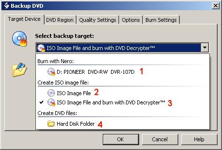

Once you have all your settings worked out, and you press the backup button, you get this:
1 means temporarily create a VIDEO_TS folder on your hard drive and burn automatically with Nero.
2 means create an ISO image file on your hard drive. You can then burn this with any decent burning software at your leisure.
3 means create an ISO image file on your hard drive, and automatically burn it with DVDDecrypter.
4 means create a VIDEO_TS folder on your hard drive. You can then burn this with any decent burning software at your leisure.
