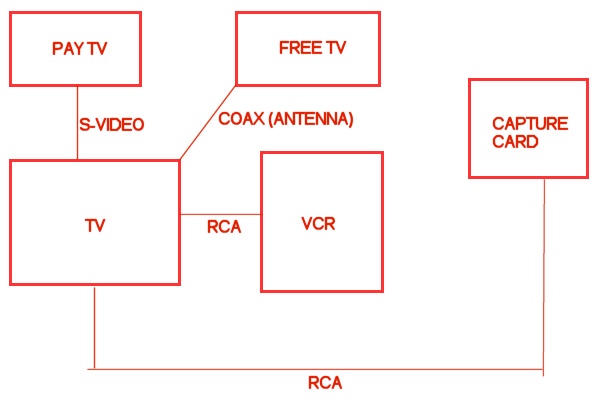

Two solutions:
Foxtel box into VCR using RCA.
Free-to-air antenna into VCR using coax.
VCR into TV using RCA.
TV into capture card using RCA.
OR
Foxtel box into TV using S-VIDEO.
Free-to-air antenna into TV using coax.
I think the 2nd way is probably better (and easier to understand).
This way whatever is displaying on your TV at the time is going to your capture card, be it pay tv, free-to-air TV or VHS.If in doubt, Google it. -
