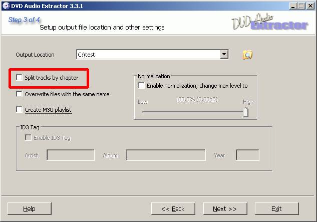

I've heard good reviews of all four tools listed here - is it possible that there's probably some setting to do with file-splitting that you may have missed ?
In particular, this one ?
I just did a test directly from a 92 minute DVD movie with 10 chapters, and it made on big WAV file with that option unticked, and took about 16 minutes to do it on my firmware-flashed LiteOn XJ166S DVD-ROM
