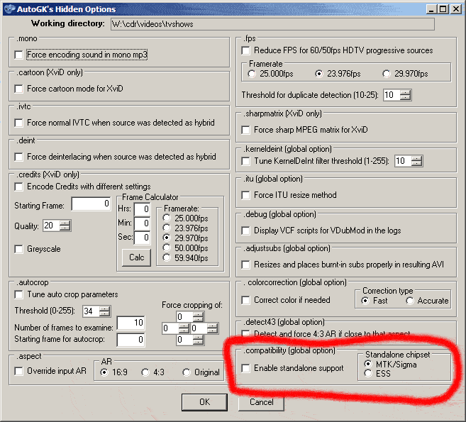

1. Change to File
2. Open the avi
2a. Press CTRL-F9 and select Enable standalone support and ESS under .compatibility and Standalone chipset
3. Set the output size
4. Add job
5. Start

2a. Don't forget to actually enable ESS/MTK standalone support with Ctrl-F9...
this way you rencode the avi though and you have possible quality loss right?
therock: yes.
hilljack: thanks. thought it was enough to select ess support when you installed the stable version. -
What does ESS support do in this case? Can it affect the audio sync or overscan?
Try ripping in IFO mode and RIP just the video you want to encode. For the main movie just do the main movie files etc.Originally Posted by digitalevk
- John "FulciLives" Colema
vv"The eyes are the first thing that you have to destroy ... because they have seen too many bad things" - Lucio Fulci
By default, AutoGK uses a couple of Custom Quant Matrices when doing XviD encodes. ESS chipset based players don't support much in the way of CQM, and if the ESS box is checked, it then switches to either the MPEG or H.263 matrix which all standalones support. Which it uses depends mostly on the results of the compress test. It's nothing to do with audio synch or overscan. -

could someone help explain the 4:3 features in the hidden menu? I would like to convert my 2.20+ ratio xvids to 4:3 xvids, to play on my standalone.Originally Posted by HillJack
1 .aspect - check 'Overide'?
check 4:3?
2 .detect 43(Global Option) - check 'Detect and force...'? -
Hi-
It's definitely not 1. That's for when DGIndex says it's 16:9 and it's really 4:3, or vice versa. Those instances are very rare.
As for 2, I'm pretty sure it's for those times that AutoGK takes a 1.33:1 movie and hands you back something slightly different. So, you use it to force a true 1.33:1.
You can do what you want in AutoCrop->Force Cropping Of, and fill in the numbers. You'll have to know what you're doing to get it just right, though. And it's a damn stupid idea if you ask me, chopping off the sides of a movie. But you didn't ask that.
What you want to do is much easier in the full Gordian Knot. -
