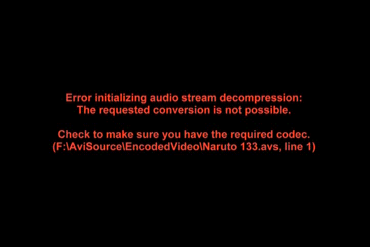

These episodes give me the error : "Frame size 722 x 56 is not supported. Supported frame size is up to 720 x 576".
I have followed the exact instructions given by Aktee and I have successfully encoded Naruto episodes 110 - 150, except for the mentioned episodes. Also, they are the only ones that return this error.
Can anyone help me? Thanks in advance. -

there's a problem with the AVS file.
Please open the *.avs file with Media Player. It should display an error.
My hypothesis: You didn't rename the files, leaving [ and ] or something like that, which messed the batch!
722 x 56 is the resolution of an avisynth error screen.

I renamed the files to simpler file names such as "Naruto 144.avi", but none of them works. When I open the *.avs file in a media player, it says:
"AviSource: Could not decompress frame 0 (C:\AviSource\EncodedVideo\Naruto 144.avs, line 1)"
However, when I try to run the batch file, it does not display the error about frame size anymore. Instead, it outputs a 2mb m2v file. I tried to play this m2v file but all it shows is the same error as above ("AviSource: Could not decompress frame 0...").
I also noticed that these four are from [AonE], so I am going to try dattebayo version of those episodes.
**EDIT: Dattebayo version of those episodes work. AonE probably didnt encode those episodes the same way as the previous ones. Thanks for your help anyways. -

and here is my besweet log:
Logging start : 12/31/05 , 00:01:27.
F:\Program Files\DVD2SVCD\besweet\besweet.exe -core( -input F:\AviSource\Naruto 133.avi -output F:\AviSource\EncodedVideo\Naruto 133.mp2 -logfilea F:\Program Files\DVD2SVCD\besweet\BeSweet.log ) -ssrc( --rate 48000 ) -toolame( -m s -b 192 )
[00:00:00:000] +------- BeSweet -----
[00:00:00:000] | Input : F:\AviSource\Naruto 133.avi
[00:00:00:000] | Output: F:\AviSource\EncodedVideo\Naruto 133.mp2
[00:00:00:000] | Floating-Point Process: Yes
[00:00:00:000] | A/V Delay found : 0msec
[00:00:00:000] +------ Shibatch -----
[00:00:00:000] | Source Sample-Rate: 44.1KHz
[00:00:00:000] | Dest. Sample-Rate: 48.0KHz
[00:00:00:000] | Attenuation : 0.0db
[00:00:00:000] +------- MP2ENC ------
[00:00:00:000] | Bitrate method : CBR
[00:00:00:000] | MP2 bitrate : 192
[00:00:00:000] | Channels Mode : Stereo
[00:00:00:000] | Error Protection: No
[00:00:00:000] +---------------------
Error 32: No input-data was found (wrong substream?)
Quiting...
[00:00:00:000] Conversion Completed !
Logging ends : 12/31/05 , 00:01:27. -
hmm, first time I see that =p.
but like the message says, did you try to reinstall your codecs?
Uninstall every codec, restart, and install them again. I use K-Lite Codec Pack, but you're free to use anything. I suggest you get the codecs indivually.. -
hey. i got it fixed. lol. i dont know why it worked but i just didnt use CCEFront and it worked. thanks for your help though.
to anyone who encodes naruto. what filters do you use if any, to increase the quality even by just a little?
i get the same error but i still end up with an MP2 file. are you saying you dont end up with a final MPG file with Audio+Video?
yes, i dont end up with a video+audio file. some one please help me i have a bunch of files to convert
