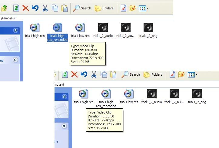

However a new problem arose with the boosted audio. After boosting the audio(now I boosted to 1536kbps), although the boosted audio's file size remained same, but, while using this boosted audio file for muxing with the orig. AVI video in VirtualDubMod, the target AVI's file size increased from 85MB to 124MB, and this file's bitrate is 1536kbps ofcourse.
Is this AVI filesize increase due to the fact that the boosted audio has 1536kbps bitrate. If yes, why hasn't this bitrate affected the boosted audio file size, but affecting the muxed avi filesize.
For confirmation, you can check out the screenshots describing the fileinfo of the original and muxed AVI files:
In goldwave, I saved the wav file as PCM audio. I realized now, that's the reason why the bitrate was 1536kbps.
I changed wav audio stream to mpeg1- layer3(mp3) while saving in goldwave with a sampling rate of 48khz and a bitrate of 224kbps - which is same as the audio of the orig. avi file.
this time again I muxed the new .wav audio file with orig avi and got the muxed avi filesize reduced to 91MB(from 124 MB when audio bitrate was 1536kbps). However, still I'm confused why is there an increase of 6MB in the filesize of the target avi file(as the orig avi filesize is 85MB) even though i use :
1.)'Direct Stream Copy' mode in VirutalDubMod.
and
2.) Boosted wav audio file with mpeg1-Layer3(MP3) stream having 48khz sampling rate and 224kbps bitrate.
Another info: The bitrate of orig avi file is also 224kbps. So, there's no increase in bitrate of boosted audio this time over.
