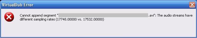

When I try to Join 2 AVI files in VirtualDub I got this error:
How can I fix it?
Reencode the audio so they are same. You can't mix different audio.
Check under File->Information to view the audio details.
Change codec Under Audio->Compression.
Set Video->Direct Stream Copy.
Save as a new avi. -
