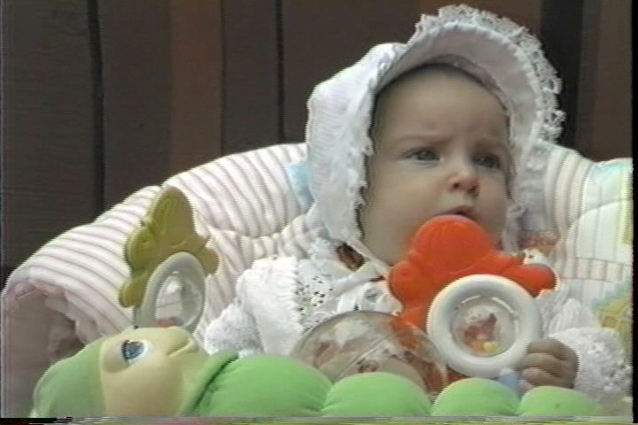

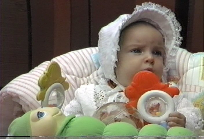

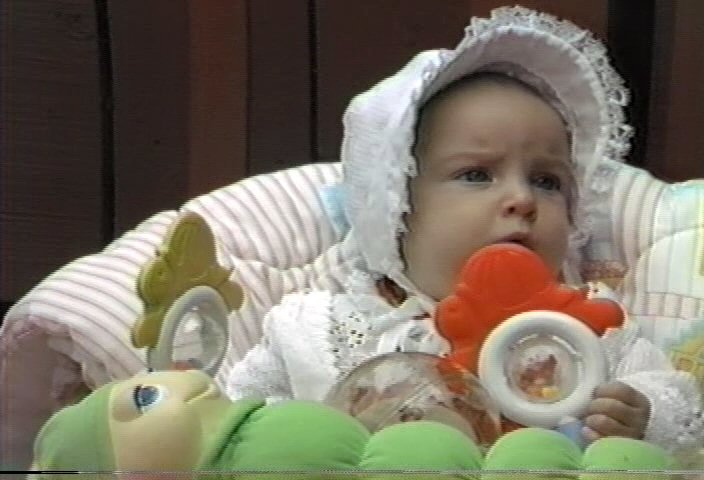

    MV5S using FR 2h5m
    ES30VS using FR 2h5m
    ES30VS using FR 1h4m

    mv5s (fr mode 2h5m)
    es30vs (fr mode 2h5m)
    es30vs (fr mode 1h4m)
    Hope these photos took.
    One thing that you cannot see in these photos (you need video clips) are the moderate-fast motions scenes which I ran some tests on last night. I was astonished at how BOTH of these dvd recorders choked during several moderate-fast motion scenes. There were macroblocks flying all over the place. Compared to my capture card these recorders are subpar. My capture card simply does NOT produce macroblocks, even with noisy VHS tapes. I need this quality in a dvd recorder.
    In conclusion, I would never use these recorders for precious video. I am going to run my tapes through an external svhs or vhs into my capture card to my PC external hard drive, like I have always done until something better comes along.
