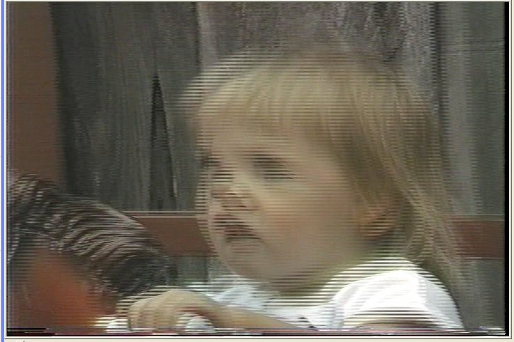

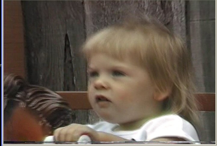

  3. You have to post your frame samples one at a time, editing your post over and over to add additional pictures. When you name the images, don't use any spaces. When choosing frames to grab with VirtualDub, find a scene with little or no movement. It will be easier to find a frame that doesn't have the interlaced comb effects you are seeing there (due to the differences in the field content caused by the movement).
    As for your captures, the Panasonic is adjusting the VHS source black level down by 7.5 IRE, the JVC is not. That's one reason the color looks more dramatic. Darker blacks make the color appear richer.

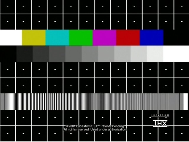

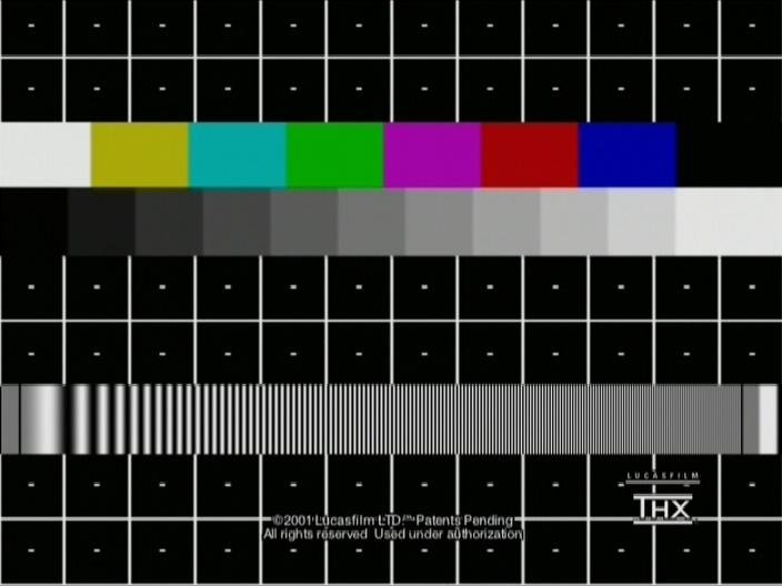

    Original THX test pattern,
    Still capture using CinePlayer
    Still capture using VirtualDubMod

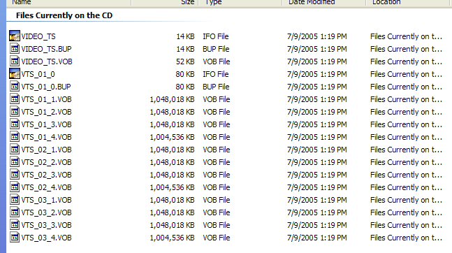

    Very screwy,
    I placed my first vhs transfer to dvd into my laptop and ran it through some software programs, i.e. Mpeg Video Wizard, Intervideo WinDVD Creator, ShowBiz, DVD Decrypter. They all read and evaluated the contents of the disc improperly.
    This listing below is IMPOSSIBLE as I am using a single sided +r disc.
    Any ideas?
  10. Is the disk finalized?
    Here is what Decrypter provides typically from a VHS capture. This a finalized dvd-r.
  11. The one thing I know the Panasonic is good for are old tapes that have sync problems. So I think with a good VCR then hooked up to a Panasonic with a TBC and a JVC DVD recorder will be the best.

    trhouse,
    Yes it is finalized. (But I will verify again.) I've never really experienced this before. Weird.

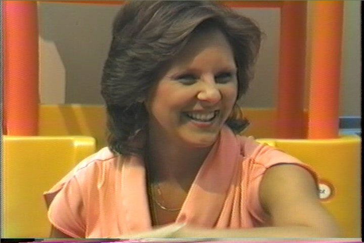

    ES30VS using FR mode set to 2h5m

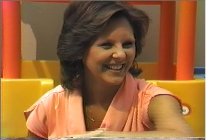

    And
    MV5S using FR mode set to 2h5m

  23. Video Restorer lordsmurf's Avatar
    I think the MV5S image here look great. They are not too dark, and are probably VERY accurate to the VHS tapes (which tend to run a little low on black/contrast as a format anyway). The color looks good too. Not everything is "vivid colors" in the real world either.
    The Panasonic images here are just very dark and have a red-shift saturation that I find entirely unacceptable.
    In the last pair of images, the woman has hair on the JVC, but this dark blob stuck to her head on the Panasonic. The JVC pink shirt is very cloth like, but the Panasonic pink shirt has compression artifacts from color augmentation.
