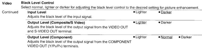

Since you have experience with the ES30VS, do you have any idea what this buyer was talking about in the following quote?
There is a setting mentioned in the manual that allows you to run the vcr through the component connection. I've never seen a vhs picture this clear.
Is this what you were referring to? -

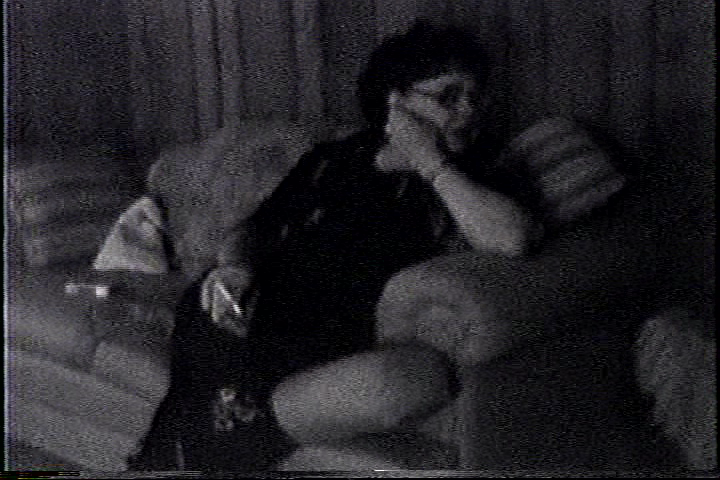

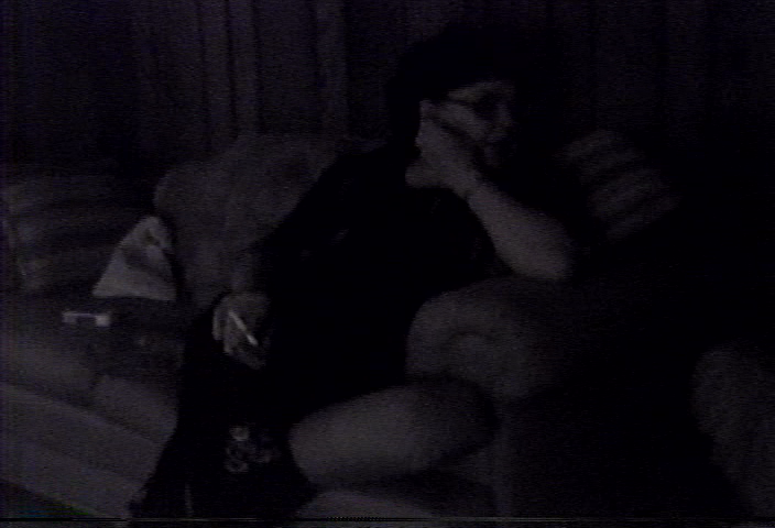

This whole idea of recording at 704x480 might put my issue to bed. Since I use quite a bit of software on my PC for editing and authoring, I don't want to have to upsize EVERY disc to 720x480 over and over again. Right now, capturing from VHS to capture card is great because you wind up with one big mpeg file.
But having to rip a disc from your recorder, paste it back together again, upsize it to720x480, and ONLY THEN start your editing and authoring? Wow! What a time burner!
I love the quality of ES30VS compared to my old equipment generally. But the darks are way too dark in my "bad" indoor scenes.
Old...
ES30VS...
, and I can't live with 704x480. I'm going to go try the MV5 today.[/img] -
Why do I always screw up these pictures?
Old capture card version...
[/img]
You need a proc amp.
I know lordsmurf...
I need a lot of things, but with sending three kids through private school, I live on a shoestring as they say.
If the MV5 VCR is at LEAST as good as the ES30VS, AND the encoder is better, I will be happy with the exchange. -
The ES30 has black level adjustments for the type of media you are recording. Have these been setup for VHS? If you get the MV5, please let us know if it has black level adjustments. I believe the earlier M10, MV1 did not.

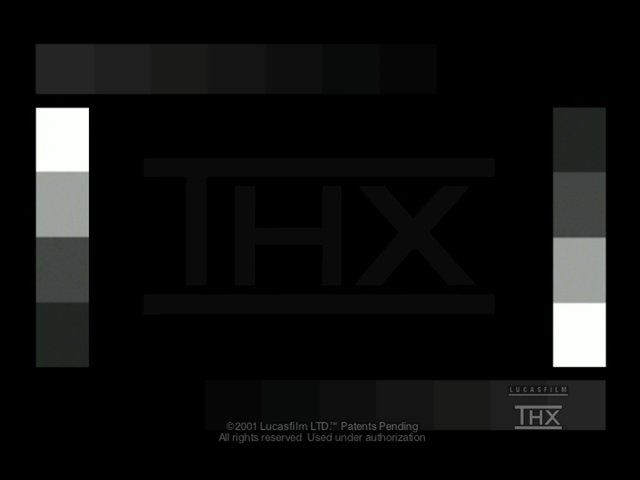

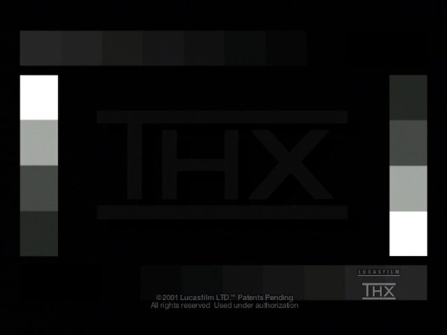

Here are two test images with the ES10 setup for a DVD test pattern source.
Original THX test pattern
ES10 copy

The black level settings I left as I found them after reading zorankarapancev's Panasonic posting. Also, I didn't think any changes would be necessary since I was using the internal VCR to dub from.

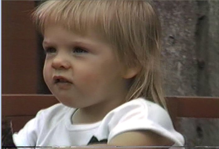

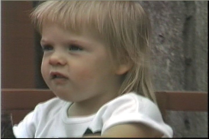

I took the MV5S back about 10 minutes ago and exchanged it for the Panasonic ES30VS. I recorded the same tape on both units and it was no contest, the ES30VS BLEW AWAY the JVC in quality, i.e. color, detail, lack of blurriness during motion scenes. I was really amazed. I'm not saying that Panasonic has the best encoder or whatever. But I AM saying that in the VCR/DVD recorder combo units, there is no contest, the ES30VS rules. I think Panasonic sprung for a better VCR than JVC.
The ES30VS captured 100 frames MORE at the beginning of the tape than did the MV5S.
The encodes from my 10 year old Panasonic VCR and Emuzed capture card looked better than the encodes from the MV5. I will post some shots.
ES30VS
MV5S
I can I can live with 704x480.
For now though, I need to get going on these transfers!!!
[/img] -
Unless the kid was sunburned when this was shot, and shot in harsh sunlight, I'd have to disagree with "better color" from the Panasonic. Not to mention the eyes went from colored iris to pitch black.
The image is darker and red-shifted.
