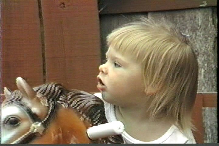

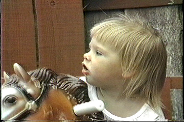

    Guess I screwed up on the images. I'll have to work on that one.
  5. Member slacker's Avatar
    Jan 2004
    SF, CA, USA
    How's this?
  6. Member slacker's Avatar
    Jan 2004
    SF, CA, USA
    ANDDDDD the JVC (on Auto)!
  7. The JVC DVD recorders clearly do a better job of analog input video noise reduction than other brands, producing a smoother image with fewer compression artifacts. This has been discussed in depth on the forum. However, it comes at the expense of some detail, and there is no provision to shut the filter off. Some other machines, Panasonic included, that have switchable video input noise filtering unfortunately do not perform this function very well. Toshiba units do have decent noise filtering (not as good as the JVC, though), and have two levels of input filtering available, plus off. Their machines might provide the "middle gound" you are looking for.
    Some of this depends on the type of TV you will be playing the DVD transfers on... standard CRT "tube" TV's are very forgiving when it comes to grain and other video noise. Larger, fixed-pixel digital displays (LCD, DLP, plasma, etc.) are not. They highlight virtually every flaw in the source material.
    I personally still like the JVC recorder best. I use a SignVideo DR-1000 Image Enhancer to sharpen the image a bit prior to recording. I find this restores most of the detail while still allowing the JVC to clean up excessive grain and chroma noise.

    No trhouse, neither.
    I used an old low end Panasonic (PV-V4522) I've had for years, and an old low end JVC (HR-VP673U) I purchased for my kids maybe 5-8 years ago. Not bad for old technology I guess.
    Which is why I'm in the market for a new recording unit. Something which can transfer my HUGE home movie collection (VHS and Hi-8). The VHS tapes go back 20 years up through 1993 and still look very good due to long term cool, dark storage. The Hi-8 took over from 1993 through today.

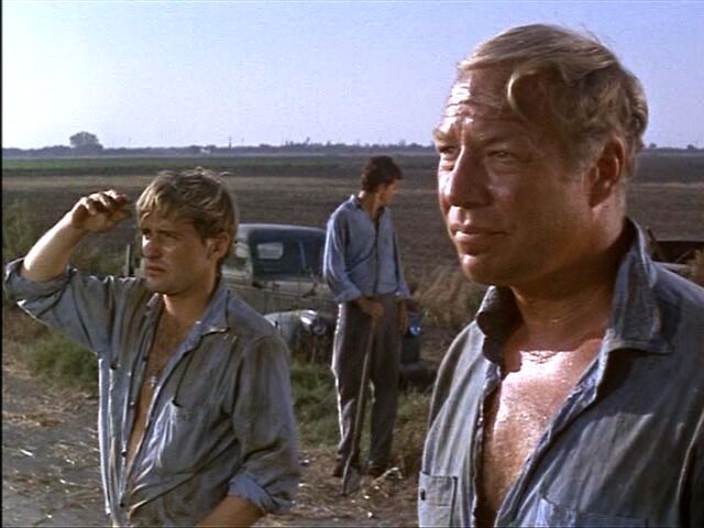

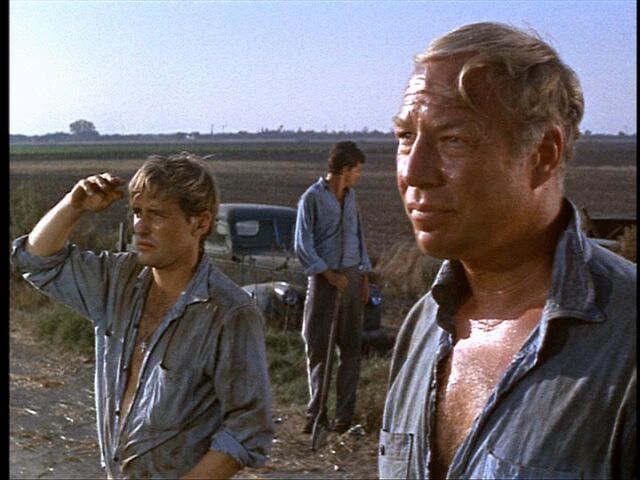

    Here are three images supplied courtesy of gshelly61 from tests done on another thread,
    Original dvd
    Panasonic ES10 SP mode
    JVC M10 SP mode
    The difference is in the sky. The original has the most noise. The Panasonic removes some and the JVC even more.
  11. Yes, there is a good example of what I've talked about. The JVC does an excellent job of suppressing grain and chroma noise prior to encoding. In the case above, the original DVD had lots of transferred film grain, probably because it is an older film that has not had a modern digital restoration yet.
    When I made analog video copies of the DVD (using the s-video output of a Pioneer DVD player), the JVC handled noise reduction better than the Panasonic. The ES10 tended to leave more grain and resulted in some associated compression artifacts.
    Why not shut off the video noise reduction and capture the original as is, with all the grain? Simple. The MPEG2 encoder will go nuts trying to do a hybrid VBR encode of frame after frame of background noise and grain, causing all kinds of nasty digital compression artifacts like mosquito noise and macroblocks.
    It is true that all video noise reduction filters that are effective also cause some amount of detail and sharpness loss. There is no way around that.
    The other alternative is to get a hard drive based DVD recorder that can encode at 15Mbps (HQ+, XP+), record with no video noise filtering at all, then do a variable bitrate "second pass" encode from the hard drive to the blank writable DVD (Sony RDR-HX900 and the new Pioneers can do this).
