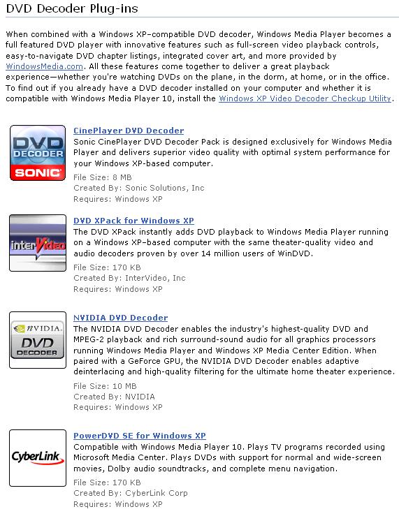

Maybe this will help.
Here is a link to see if you have a compatible decoder,
http://www.microsoft.com/downloads/details.aspx?FamilyId=DE1491AC-0AB6-4990-943D-627E6...displaylang=en -
Yes, sorry, I should have mentioned that I had tried that utility as well. It only indicates that I can't use WinDVD (from InterVideo) to sync with MCE, but that seems irrelevent since I don't even have an MCE machine. Also, I watch normal DVDs from Blockbuster all the time with no problems - menu comes up fine from the beginning.
