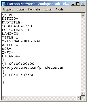

    I use VirtualDubMod by preference and when I select the TextSub filter I get the appropriate options as shown on the howto. However when asked to select a subtitle file I choose the .srt file and click OK. The TextSub filter returns to the basic option screen where the [OK] button is greyed out. The text box that should hold the subtitle file name is blank. Nothing I can do seems to be able to get past this point.
    Any ideas? Is there an earlier version of VobSub that maybe works?
    I'm having the same problem as nojay has...
    I don't know how can I "fix" this problem...
    made with subtitle workshop
    my .sub file is here:
