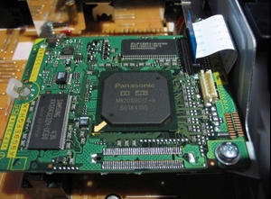

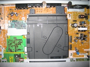

    First of all, it is obvious that this is the first revolutionary change in the Panasonic production line of the DVD recorders. Until now Panasonic was moving in the evolutionary spin trying to fine tune the original design placed on the market some years ago. The new DIGA family of DVD recorders is a revolutionary step forward for this company and it is based on new hardware and on their original and modified software.
    See the differences between the old and the new hardware design on the uploaded images.
    In order to avoid any problem with the quality of the feeding signals (you know the rule of tomb: garbage in – garbage out), I made all my tests with the Sony broadcast DVCam camera DSR300A + Canon YH18x6.7KRS 1x12 lens (800 lines of resolution), Sony DVCam DSR-11 player and Sony UVW-1800 Betacam SP deck.

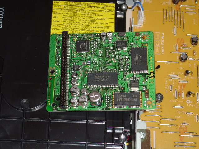

  10. Those are good photos. If Panasonic deserves any prize, it should be for product design. I opened mine to see if you had removed any internal covers but that is not the case. The design is very clean and lends itself to very automated production.
    Only a few wires are visible including to the front panel on/off switch. There is no fan. The power supply only has a tiny heat sink but it does not feel very hot in standby. Only two ribbon cables visible. One from the power supply to the main board and one from the processor board to the drive.
    I checked out most of the visible IC's on the processor board.
    Samsung K4S643232H is a 2M x 32 memory
    Elpida DD5116ADTA is a 32M x 16 memory
    Burr-Brown PCM1780 is a 24 bit audio DAC
    AKM 5357ET is a 24 bit audio ADC
    The main board seems to have no active devices that are visible. I am a bit doubtful that the one big Panasonic IC could be the entire rest of the recorder so I will guess that if the little board is turned over there will be more parts.

  14. I had hoped to resolve whether the ES-10 has a 12 bit input ADC by flipping over the the video processor board.
    The Elpida S6432AFTA is another 2M x 32 memory
    The Samsung K9F6408UOC is 8M x 8 flash memory
    The M 445 remains unidentified but the "M" logo belongs to Microchip which makes microcontrollers and DAC's but not video ADC's.
    The Sharp 025GN01 remains unidentified but bears some resemblance to their voltage regulators.
    The OKI R27V802F remains unidentified. They do make display controllers.
    One chip has BU2365FV with no manufacturer identified.

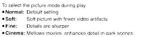

    Originally Posted by zorankarapancev
    It is important to mention that this 3D DNR is a powerful filter and if is set permanently on ON, used in a good VHS signal, it can add unwanted artifact on the recorded image. I would prefer to see multi stage settings (1, 2, 3…) instead of a simple ON/OFF. With the implemented TBC now it is possible to have several picture modes: Normal (default setting), Soft (soft picture with few video artifacts), Fine (sharper details) and Cinema (enhances detail in dark scenes). For further reduction of the picture degradation there is also an MPEG-DNR circuit that can be switched ON or OFF.
    Please clarify, are you saying that these types of switches exsists in this unit or are you speaking in terms of a wishlist?
    I agree that a selection switch indicating sharper or softer images would be just what most of us need.

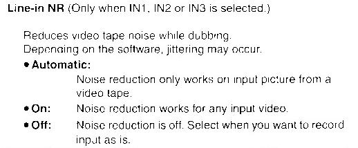

  21. ejai,
    For the adjustments of the picture quality and the Line-in NR noise reduction filter go to page 25 of the Operating Instructions Manual.
    As I mention earlier, for the videos with extensive camera movement, as well as subject movement, the digital artifacts are more pronounced than with the older Panasonic generation. That is why I pointed out that the LP recording on these new models is not a substitute for the SP mode. For any program up to 3 Hrs the best option is to use the FR mode. Again, it is a mistake to compare the quality of the SP and LP modes of the recording. The LP recording mode is good only for certain video images.

    There are no adjustments to the NR. It's on or off. If you stick you eye really close to the tv set, and stare, you can see a small improvement going from on to off. But that's it.

    For the adjustments of the picture quality and the Line-in NR noise reduction filter go to page 25 of the Operating Instructions Manual..
    Thanks, I was looking for these controls in the recording section, not playback. I would love to see this type of control on pre not post recording. If we had this kind of control I feel most people here would be extremely pleased.
    As I said before I am continuing to test the unit for my own purposes. I must admit it does as you said, it cleans up the incoming signal quite nicely.
    Do unto others....with a vengeance!
  28. I would love to see this type of control on pre not post recording. If we had this kind of control I feel most people here would be extremely pleased.
    It is on pre recording.
  29. Line In NR is pre,
    Picture mode is post,
