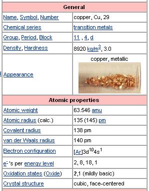

  9. P.S. I did not realize copper existed in crystalline form but it does. There are numerous references on the web.

    Yes - I've found plenty of web refs and web pics for copper crystals too. Seems like atlas' web site as per my link above is actually talking sense.
