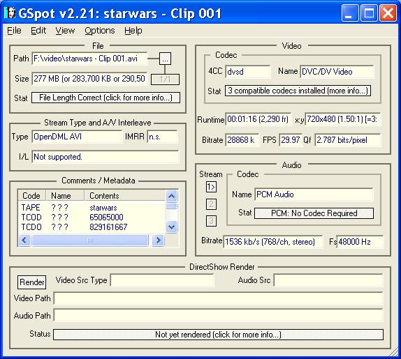

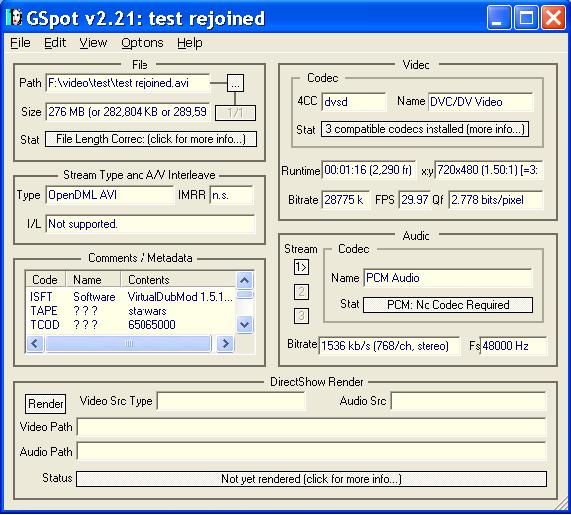

Well I tried again splitting files with VirtualDubMod. I used Direct Stream copy to split. Then I rejoined it. There is about 1MB missing after rejoining the file. This happens only on the first rejoin. Multiple splitting/rejoining doesn't lose any more data.
I loaded the files in Gspot. As you can see, Gspot says the bitrate has changed. Bitrate was reduced from 28868k to 28775k. This is odd, since I did a Direct Stream copy(no re-compression). What is going on? Does Virtualdub change the DV Type? Gspot doesn't show DV Type I or II.
might have just stripped off some metadata strings

As far as your odd numbers are being revealed screwy, is probably
on account of the type of AVI format being used. And, during the
re-creation of the DV AVI (if using vdub) will use a different
AVI format, and this is what is causing your odd filesize reporting
in GSpot. I know that vdub uses a different AVI format than my DV
capture app uses. I too fumbled with this one, till I realized what
was going on. Not everyone stick to the script. (have you looked
at the AVI reference lately ? There is lots of room for variation,
but the job still gets done properly. Only a few odd bytes gets
tossed or added) For example, you have AVI 1.0x and OpenDML formats. Both
do the same things, but in different ways. Although the filesize
might change (slightly) the frames will all still be there, and in
there rightful place
-vhelp 3433 -
