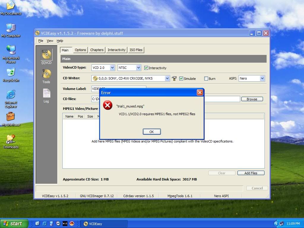

Now, at this point I was very excited that what I got is an MPEG1(VCD) file and I could burn it using VCDEasy.
Unfortunately, when I opened VCDEasy, and started adding this multiplexed file, it popped out a window saying that MPEG2 files cannot be added, and to make a VCD an MPEG1 file is required. It also suggested to use TMPGenc for this purpose. However, it was already clear that the TMPGenc's "Simple Mutliplex" option simply gave me back the original MPEG2 video, this time with an MP2 audio.
Not only that, but also another point that I noticed is --> When I multiplex(.m2v and .mp2 files) in any one of the follwoing MPEG1 modes in the MPEG Tools of TMPGenc Plus i.e.,
1) MPEG1 System(Automatic)
2) MPEG1 System(VBR)
3) MPEG1 Video-CD
4) MPEG1 Video-CD(non-standard)
what I get is again the same MPEG2 file.
Why this happened, even I don't know. But it happened, that much I know.

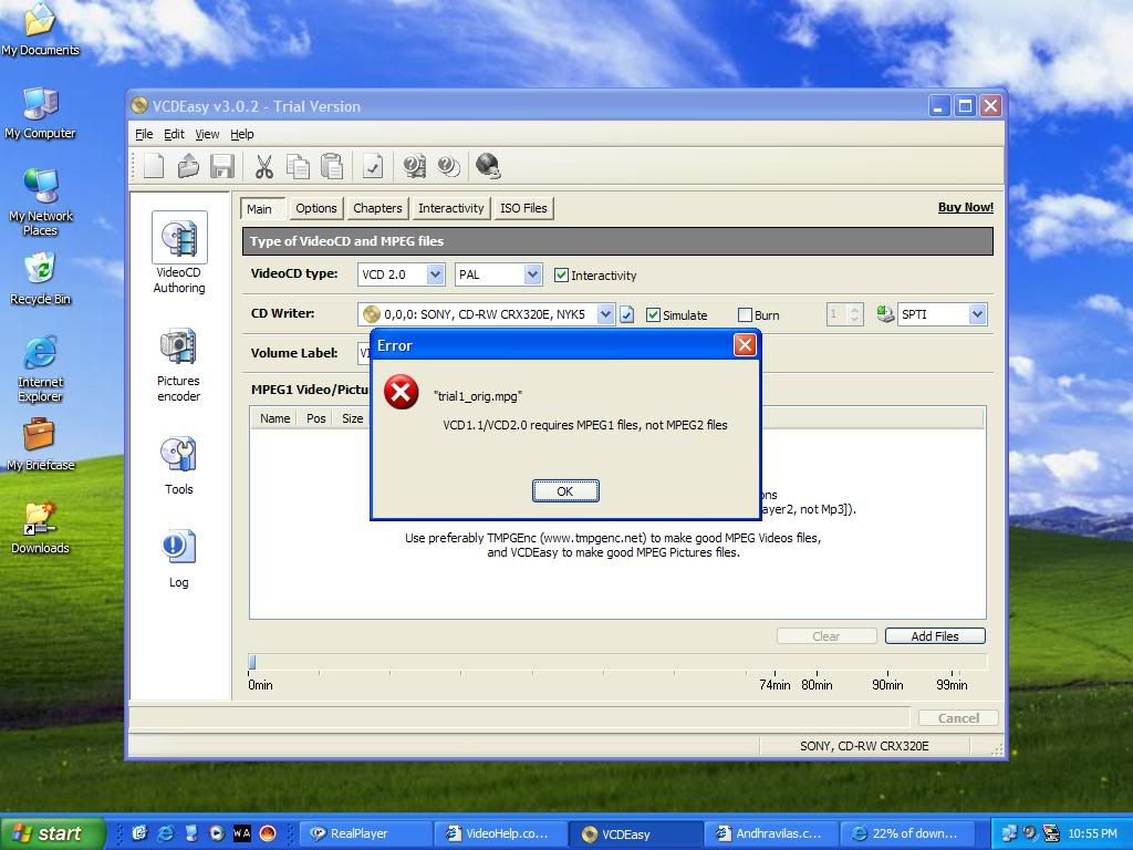

Which version of VCDEasy? I have 1.1.4 and it makes vcds with mpeg2 simply flawlessly. If you are using some very new version I am not surprised - they claim it has better compatability authoring engine (or something like that) - so it recognises mpeg2 under mpeg1 headers. -
my version is 3.0.2. This is how it appears after adding an mpeg2 video(multiplexed as told by you):Originally Posted by Abond
Aha, exactly what I thought. Then use 1.1.4 or 1.1.5 - the last you can download from this site.
where can i download v1.1.4....the original website doesn't provide this version, as only the latest version is made available in the site i.e., v3.0.2...can u help me in any way - like posting the setup file on rapidshare or sending a mail to me.Originally Posted by Abond
As I said 1.1.5 you can download from this site where we are.
https://www.videohelp.com/tools?tool=VCDEasy -

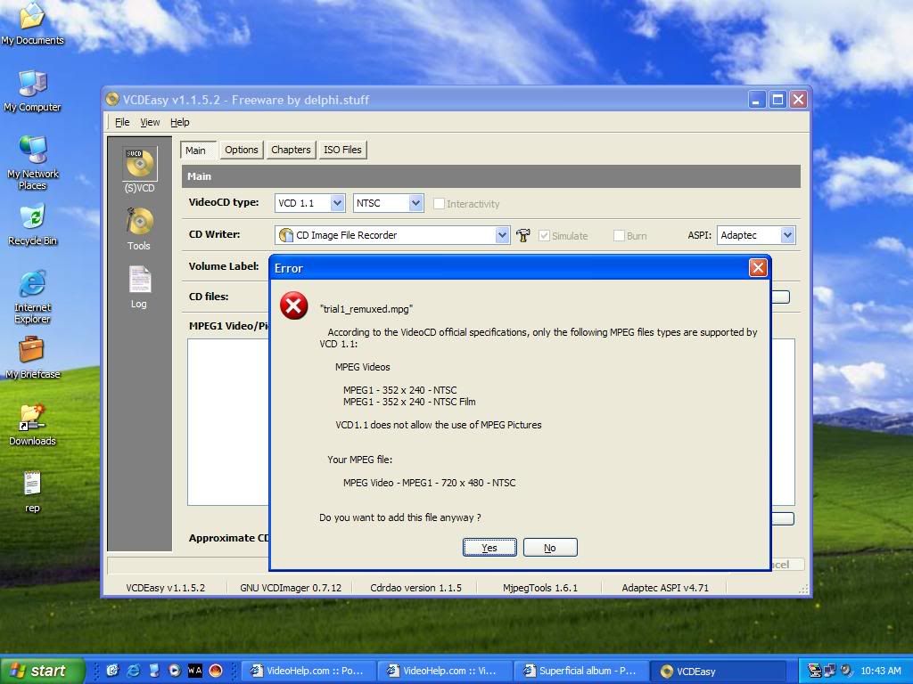

Now, comes the shocking part. I played the video, and noticed to my surprise that the audio is playing but the video is lost - i couldn't see any video frames at all. The screen is blank and black, but the audio is running.
The same thing is happening when I multiplexed m2v and mp2 files in any one of the modes present in the Multiplex or Simple Multiplex option of MPEG Tools in TMPGenc Plus. The modes I tried are:
1.) MPEG-1 System(automatic)
2.) MPEG-1 System(VBR)
3.) MPEG-1 Video-CD(non-standard)
In all the above modes, when I multiplexed the m2v and mp2(in the same order as told by Cornucopia), I got the respective MPEG1 stream videos, but when played are showing up blank & black screens with only the audio present.
Now, you guys must be having a doubt whether I really got the MPEG1 stream or I got the MPEG2 stream again. For this purpose I used Abond's idea of testing with VCDEasy v1.1.5. Take a look at the screenshot:
So, VCDEasy is accpeting an MPEG1 file, but, with a warning message. Hence, the doubt of whether I got an MPEG1 or MPEG2 file after multiplexing is clarified now. So, that's it, now forget about the warning message etc, coz that's not the topic of interest here. We'll discuss it after solving the current problem.
(Remember VCDEasy accepts MPEG1 files ONLY when the VideoCD type option is changed to VCD 1.1 - this is very important - Abond, for you especially, coz if VCD 2.0 is left, then the same old message appears saying that it wouldn't accept MPEG2 files)
So, now anyone of you two guys tell me where did I go wrong and why am I not getting the picture but getting the audio only.
