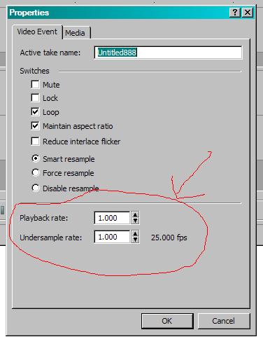

    i have a little movie, and want to make it to move 2 times faster, i'm setting the playback rate to 2, well it plays double faster, but cause the "square" of the movie in the time line is still the same, it continues to play it again (if loop is set) or just the screen stays the same, if the loop is not set.
    I want to make it just to play it 2 times faster and continue to the next one....
    yes i can try to adjust the "square", to make it smaller in order to finish exactly with the end of the 2 times faster movie, but this is not the smart way, and is too slow when i have to do it for... like 50 little movies which i have to connect and set differend playback speeds
    so, is there a smarter way to do the task?

    That is the only way if you use the velocity envelopes (that's what vegas calls them). You are changing the playback rate, so the clip reaches the end faster. You have to adjust the length of the clip to match your changed speed.

    in movie studio or vegas , right click on media properties and change playback rate is all you have to do
    you can also hold the control key down and click the end of the clip with the mouse and drag it right or left ..
