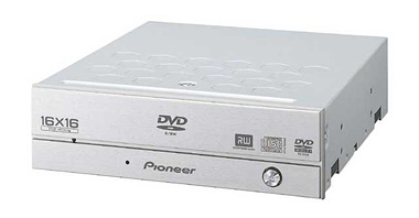

I think theres also a physical difference to it too. My 109XL has hexagon shaped design for noise reduction on top of the drive:
If the 109 has it too, then its ok. Or it maybe possible with just the firmware. -
the 109 doesnt have that honeycomb look on top, and it has a standard tray.
