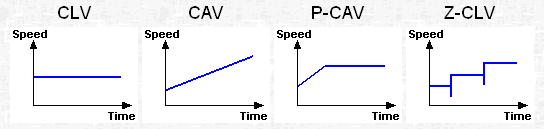

    If you look in the Nero CDDVDspeed help file, you will see a little diagram describing the different methods used to write a disc (CLV, CAV, P-CAV, Z-CLV).
    Here is the diagram:
    CLV = speed of disc rotation is changed to maintain a constant transfer rate from the inner most to outer most edge of the disc.
    CAV = Speed of disc rotation is constant, thus the transfer rate is slowest towards the inner edge, while it is the fastest at the outer edge.
    P-CAV = a combination of CAV and CLV.
    Z-CLV = the disc is divided into " CLV zones" each of which are written to at a constant speed. For example, a 12x write might be divided into 6x, 8x, 10x, and 12x zones.
    Z-CLV can be slow, I have heard of instances where a 16X Z-CLV burn took longer than a 12x CAV.

  7. Originally Posted by Skith View Post
    As for DVD-writers vs recorders: the term "writers" is usually used in reference to drives used with personal computers, while "recorder" means a set-top (stand alone) device (the kind you hook up to a TV).
