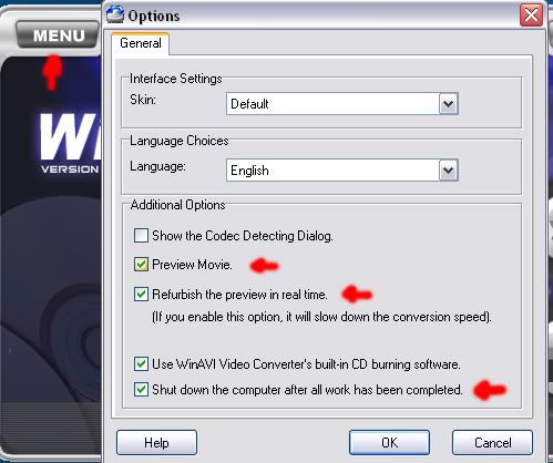

I have not had many issues with WinAVI, but I did have a problem converting a .AVI file with subtitles into DVD format. To fix the problem, I downloaded VSFilter. I'm not sure what ipred is talking about or what his rationale is; I didn't mess with those settings. Once you download VSFilter.dll, you have to copy it into c:\program files\WinAVIVideoConverter.
