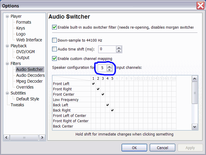

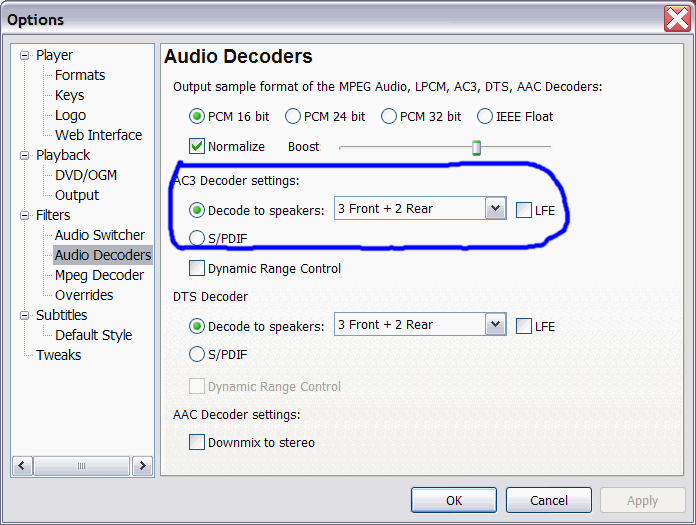

    OK. I assume you have an audio only file in AC3 and not trying to play AC3 from a dvd video.
    I did a test in media player classic and can play the an audio only AC3 perfectly in 5.1 surround.
    Did you enable 5.1 channels in MPC in the audio properties:
    and
