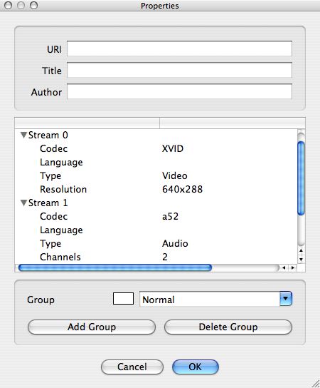

Xvid is a divx variant and a52 is another name for ac3. ffmpegX should be fine.

In your screenshot above, if you scroll downwards a bit it will give you some info about the audio. What does it say? -
Codec: a52
Channels: 2
Sample Rate: 48 kHz
Bitrate: 192 kbps
