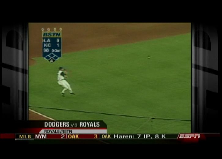

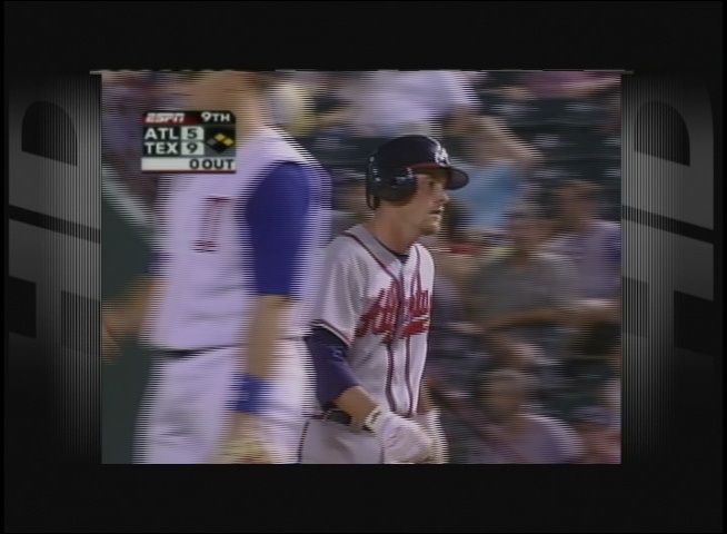

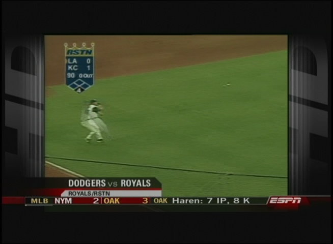

Typical motion in interlace display on a computer progressive monitor. Perfectly normal and it won't be on the TV when DVD is played.
Use a deinterlacing viewer like PowerDVD for the computer.
This is a pan.
This is player motion in front of a relatively stationary camera.
Note the ball upper right.
Deinterlacing viewer. In this case Ulead Video Studio 8.
