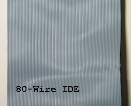

  7. Member Skith's Avatar
    Bottom of the ocean
    here are some pics to help.
