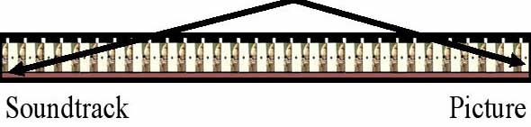

In 8 mm o super8 mm films sound track is on the edge and looks like a very narrow, brown magnetic tape. It is read by a magnetic head. In 8 mm film there is only one sound track instead in super 8 mm film there are usually two sound track; one on each edge.

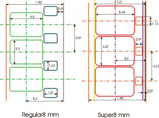

Sound as mentioned is like a strip on the side and only super 8 has sound. If you look the strip of film next to each other you will naturally tell which one is super 8. older standard 8 film has smaller frame and notch holes
see picture...
http://www.filmforever.org/displacement2.jpg -

You can tell the difference between 8mm and Super8mm, usually by looking at the sprocket holes. 8mm has rectangular ones that take up a good chunk of real estate, Super8mm has square ones that a a good deal smaller.

you need them side by side to compare them.. super 8 has small notches, and both silent and sound film was availableOriginally Posted by LSchafroth
regualr 8 has smaller frame size, and the holes are closer together and larger than the super 8.. plus it ownt have sound at all.. if you take a picture of the film stock and show me, i can tell you just from looking at itA penny saved is a waste of time. One in the hand is only worth 0.5 in the bush. A stitch in time saves nothing. -
