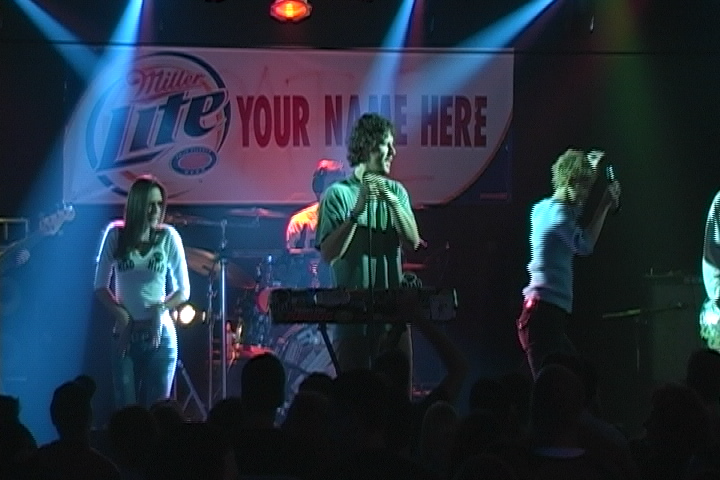

Compare it to this :P , I'm guessin everyone around here is getting a little tired of these pics.Originally Posted by vhelp

Coalman : On that screen shot, the guy on the left , right side of face around the mic. area has some Distortion/feathering ?

I think you're seeing things. Psychological. I see lots of that.
I see normal interlaced video (4x enlargment):Originally Posted by Resolution
There is a little macroblocking around the guys left arm and some ringing artifacts (these could be from the JPEG compression). -

Here's a similar BMP, there is some slight compression atifact from the JPG but not much, the checkerboard pattern mostly.
BTW, I'm taking these screenshots directly form my editor. The aspect is incorrect, they should be 16:9. They are both from the original DV.
