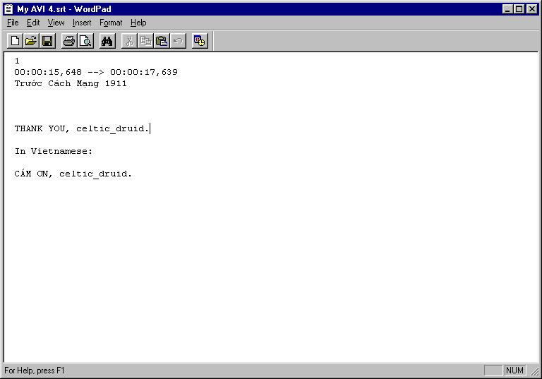

Hi celtic_druid:
I cannot use notepad to open any subtitle file (.srt). The computer would tell me that the files are too large to use notepad. I have to use wordpad to open the files.
In wordpad, I would be able to type Vietnamese words using unicode but that's it. When I save it (as .txt or or .srt), all my Vietnamese typings would turn into some strange combination.

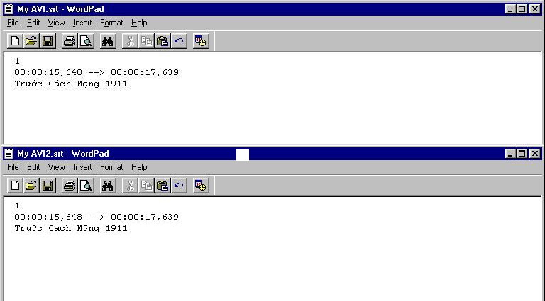

Please take a look at the pictures below.
What I typed and what it looked like after I saved it:
Looks like it is being saved as ANSI, so you loose all unicode characters. Do you not get the option to save as a unicode text document under win98? I do here under win2k and it works fine. Save as a regular text document though and you get ?'s like in your screen shot.
