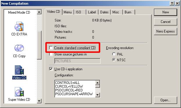

  4. wow - quick response.. thanks... only can you tel me where this tick box is? can't see it in nero express or straight nero...
    thanks mate - appreciate it
    EDIT - Mats, I'll go get VCDEasy! In the meantime if anyone can point me to this tickbox in Nero, I'd be interested to see if it works. Ta
  5. VH Veteran jimmalenko's Avatar
    Aug 2003
    Down under
    here she is ....
    If in doubt, Google it.
