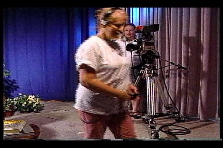

I should be more careful with my terminology. Block artifacts are more appropriate to describe MPEG problems. I have included a picture below. Must be a field since the picture I'm viewing on my external monitor has flagging between the fields everywhere you see a "buzz' surrounding the the image of our floor director as she crosses in front of the camera. Anything in motion looks like it is swimming!
That's called combing, it results from the computer displaying two fields at once.
If your final output is for TV, don't worry about it, it will display properly (as long as the field order is correct and you haven't rescaled).
If you're producing video to watch on computers, you need to de-interlace it. SmoothDeinterlace works great for this. -
If I may add to your video issue..
It seems that your video is being resized. Two indicators show
up in my head.
1 - The boarders at the top and bottom, and the vhs signature at the botttom.
2 - The interlace looks wrong. More like a misfire, due to incorrect resizing.
Line 1, where it gave itself away to me was the gray signature at the bottom
of the vhs, just above the boarder. * That * signature should be at the very
bottom, but for some reason, is on top of the boarder instead. This indicates
to me that the video was resized, and then boarders added in.
Line 2, With the interlace. It looks all wrong. This is due to the issue
with Line 1, with the "mysterious" resize that took place. The interlace
should always look smooth-combed, but instead, it look like every other line
was combined on top or something. I don't know. I can't seem to explain
it in words
According to your last script you posted:
I don't see any resize filter of any sort in there, (unless you added it inCode:avisource("D:\Adobe\PrEl\Capture\PowerTalkPSA.avi") ConvertToYUY2 SeparateFields() odd=SelectOdd.Convolution3D (0, 6, 10, 6, 8, 2.8, 0) evn=SelectEven.Convolution3D (0, 6, 10, 6, 8, 2.8, 0) Interleave(evn,odd) Weave()
later on, without telling us) Or, it could be on account of one of the
filters (combo) above, though unlikely.
Or, I would say that your encoder software is doing something funky with
the encode. I dont' know, because you didn't say if the pic you posted
above was from the actual AVI file, or from the encoded MPEG file, or
from the encoder software's editing window, or something else. I am
simply going by the pic your posted above.
Also, fwiw..
captured video, in most cases, are not really ment to be played back
at full speed. On some system setups, you can get away with it, and
on others, no. It all depends.. though, too many variables to explain.
-vhelp 3402 -

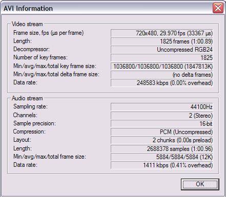

I originally posted here to obtain a better understanding of frameserving. I found on Sourceforge and installed the PremiereAVSPlugin v1.5 which apparently is a "frameserver" plugin. The docs say it should work with Premiere 5.x, 6.x and Premiere Pro. Its' release date predates Elements but I'm told that Elements is a 'Lite' version of Premiere Pro -- should be useable. Is anyone familiar with this plugin?
Using an AVS script containing ONLY "AVISource(filename.avi)" I have reported already that a disturbing re-sizing occurs which shows black borders at the top and bottom, as well as VCR head switching noise which should be safely outside safe margins. The PremiereAVSPlugin comes with a configuration GUI displayed here:
It mentions re-sizing. I have no idea why. Seems best to work on one problem at a time so, will work on the re-sizing problem first. I tried the top-most option first and got what was displayed in my field-capture from the timeline of Elements. I just tried the bottom-most option and had the very same result.

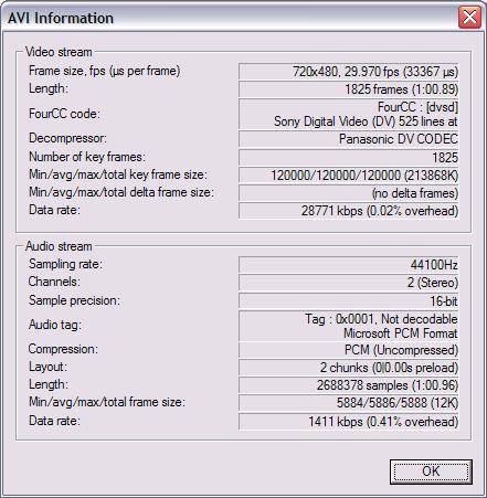

Let's start at the beginning. Go get VirtualDub, load the PowerTalkPSA.avi into it, and click File, File Information... and post a screenshot of that info. Then load the .avs file you created into VirtualDub and do it again. This will give us a lot of info about what's feeding INTO Premiere.
(edit) The more I think about it, the more I'm convinced it's the pixel aspect ratio (PAR). The frames coming in are 4:3 720x480 which is .9 PAR. Premiere is assuming that it's 1.0 (a 1.5:1 picture) so it's squeezing it to fit in the 4:3 output. Either set Premiere to realize the input is .9 (preferred) or add a line to the script to resize to 640x480 so it is 1.0 PAR (at slight quality loss). -
Loading my file into VirtualDub as AVI below:
Loading my file into VirtualDub as AVS, but only loading my file:

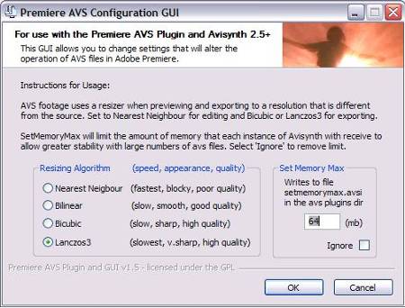

In VirtualDub both instances have the same aspect. The PremiereAVSPlugin is definitely causing the problem
Adobe Premiere Elements was created to work only with DV-AVI files. There are no controls provided for PAR. Perhaps the plugin coders made assumptions about PAR in Premiere Pro that are not valid for Elements?The more I think about it, the more I'm convinced it's the pixel aspect ratio (PAR). The frames coming in are 4:3 720x480 which is .9 PAR. Premiere is assuming that it's 1.0 (a 1.5:1 picture) so it's squeezing it to fit in the 4:3 output. Either set Premiere to realize the input is .9 (preferred) or add a line to the script to resize to 640x480 so it is 1.0 PAR (at slight quality loss). -
Can you lock it to 4:3? That should work as well.
If not, just for giggles, add this line to the end of your AVS script:
LanczosResize(640,480)
Now load into Premiere and see how it looks. If this fixes it, and there is really no way to change aspect ratios in Premiere, then this may be your only solution. The frames coming in from the plugin aren't recognizable as DV any more (they are now raw uncompressed), and Premiere could just be assuming they are square pixels (1.0 PAR) with no way to change the assumption.
